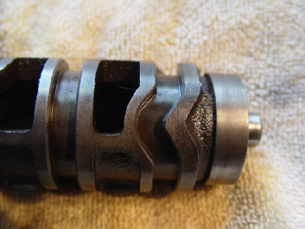

The selector drum rotates and the selector forks are moved side to side by the channels cut into it, the selector forks have a peg that sits in the channels.

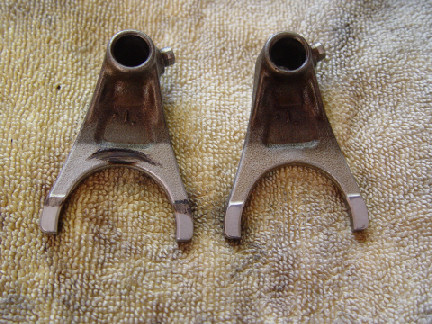

The selector forks slide across located by rods through the holes. The fork fits in a groove in the gear/dog clutch. When the drum moves the forks, the forks move the dogs into or out of engagement.

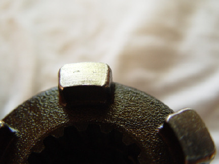

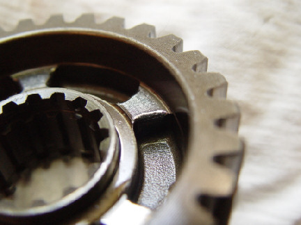

The above two pictures show the dogs and how they fit together. When the selector forks slide the gears together the dogs (the castellated areas on the sides) can engage. When the forks move them apart they disengage.
