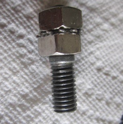

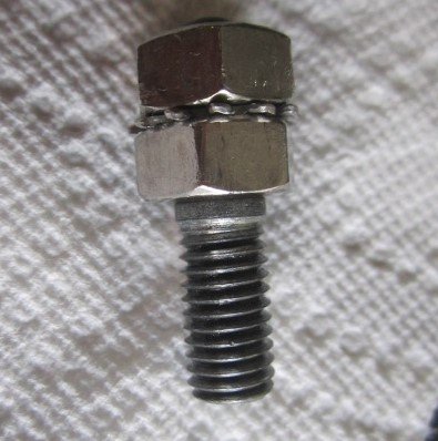

I don't trust myself to not let go of the mudguard while it is under tension when remounting it, so I chose to unscrew the studs using the tried, and occasionally successful, method of using two nuts with an external toothed lockwasher between them, and then replace the studs through the repainted mudguard holes once it is in position.
I sprayed a bit of easing oil (Blaster is my fave) onto the studs, gave them an oblique tap with a hammer, then I used the tried, and occasionally successful, method of removing the studs by threading on two nuts with an external toothed lockwasher between them.

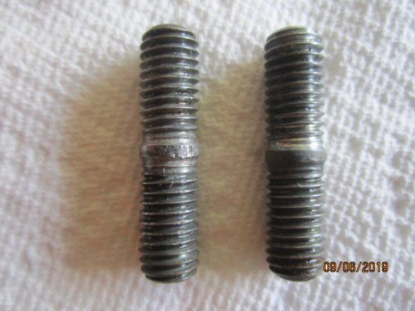

I hit the "submit" button before I was finished with the stud removal post, so here's the rest of the info:
All studs came out with no stubbornness or damage, which is good, because the studs, Ducati part # 0684.37.583, are apparently made of the rare element "unobtainium", as I could not find any online in the usual places
Each stud has a flat end and a rounded end; the flat end goes down into the hole in the "wheel carrier" , and the rounded end protrudes. The difference between the two ends is subtle but noticeable.
Once the mudguard is in place, there will still be JUST enough thread to get two nuts (but no lockwasher) onto the stud to secure them in the wheel carrier.
