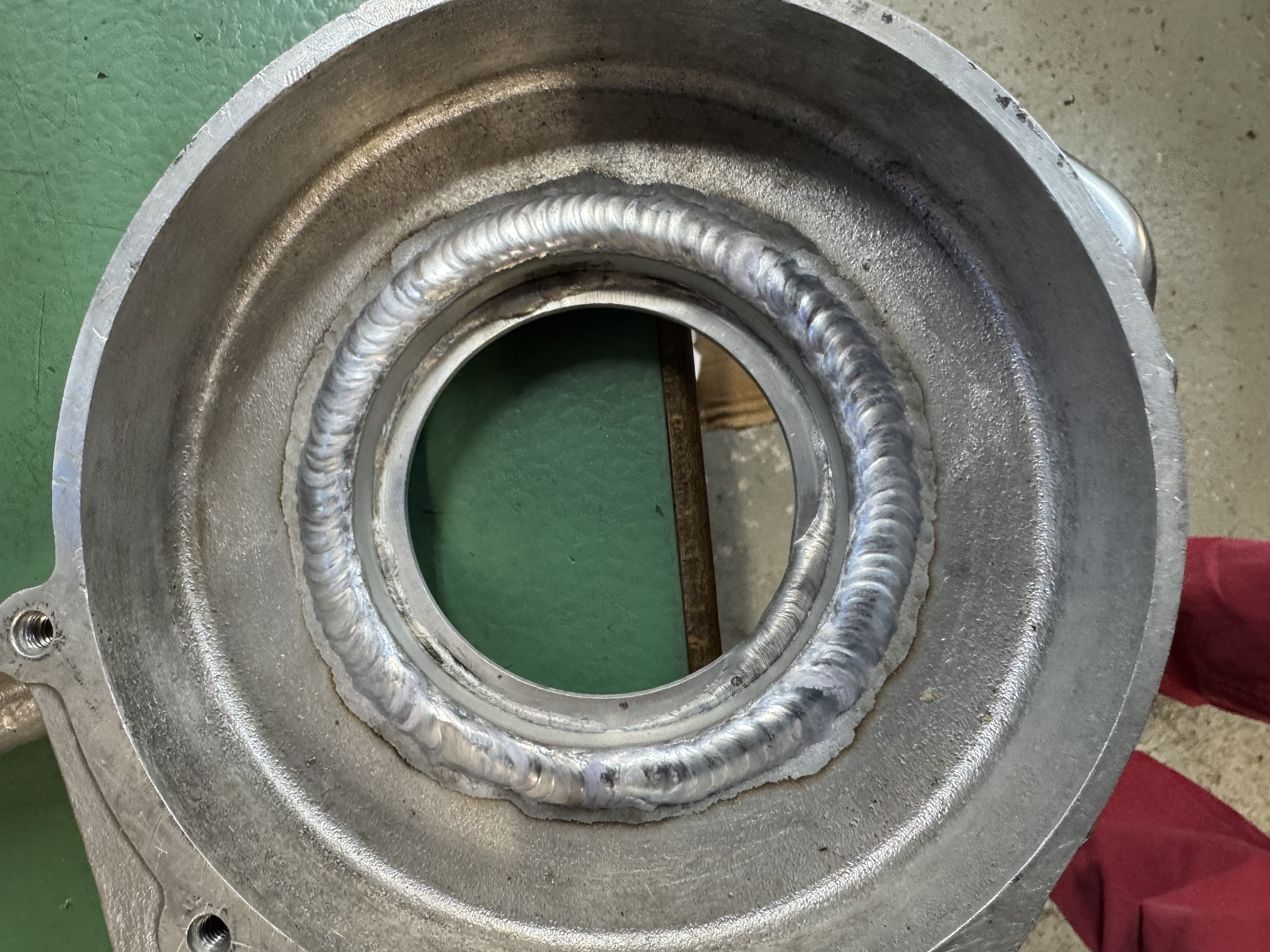

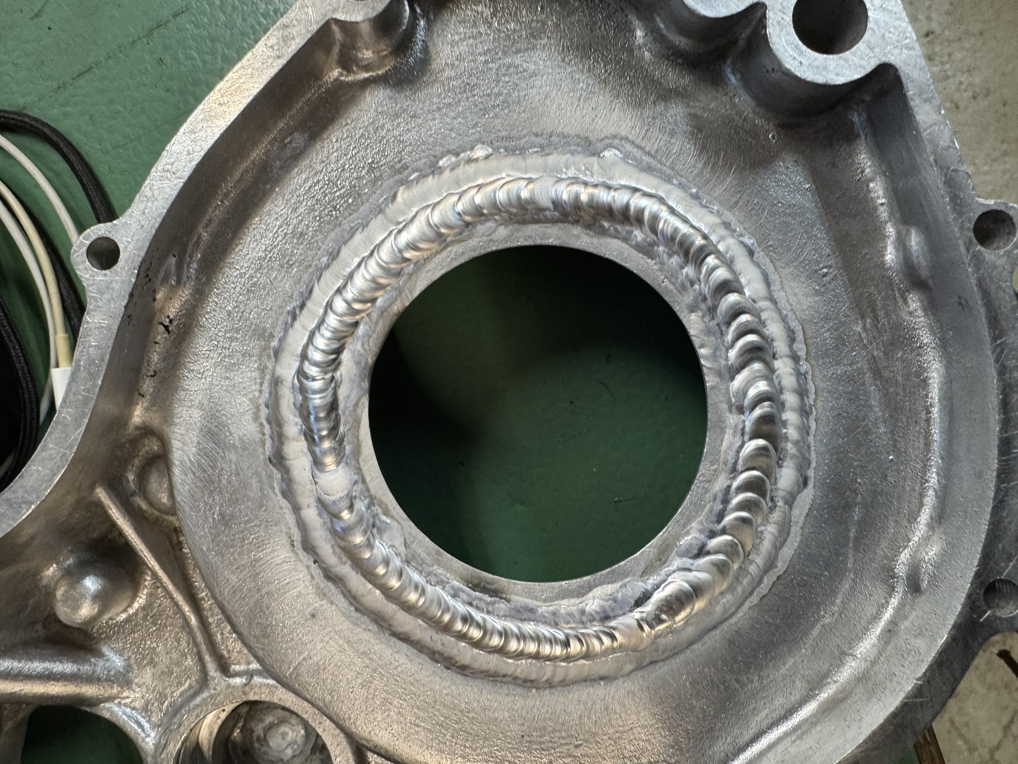

I've now got hold of a mille mainshaft.
There seems to be some room under the inside of the inner clutchcover.
So I'll weld 2.5mm on the inside and some welding on the outside on the outer diameter of the hole.
So I can put a 75x95x12mm seal on the inner cover.

Re: Thickness of Ducati Mille clutch large seal
Welding done and heattreated in the oven at 175degrees celsius for 8 hours.
Next week I will machine is in my rotary table.
