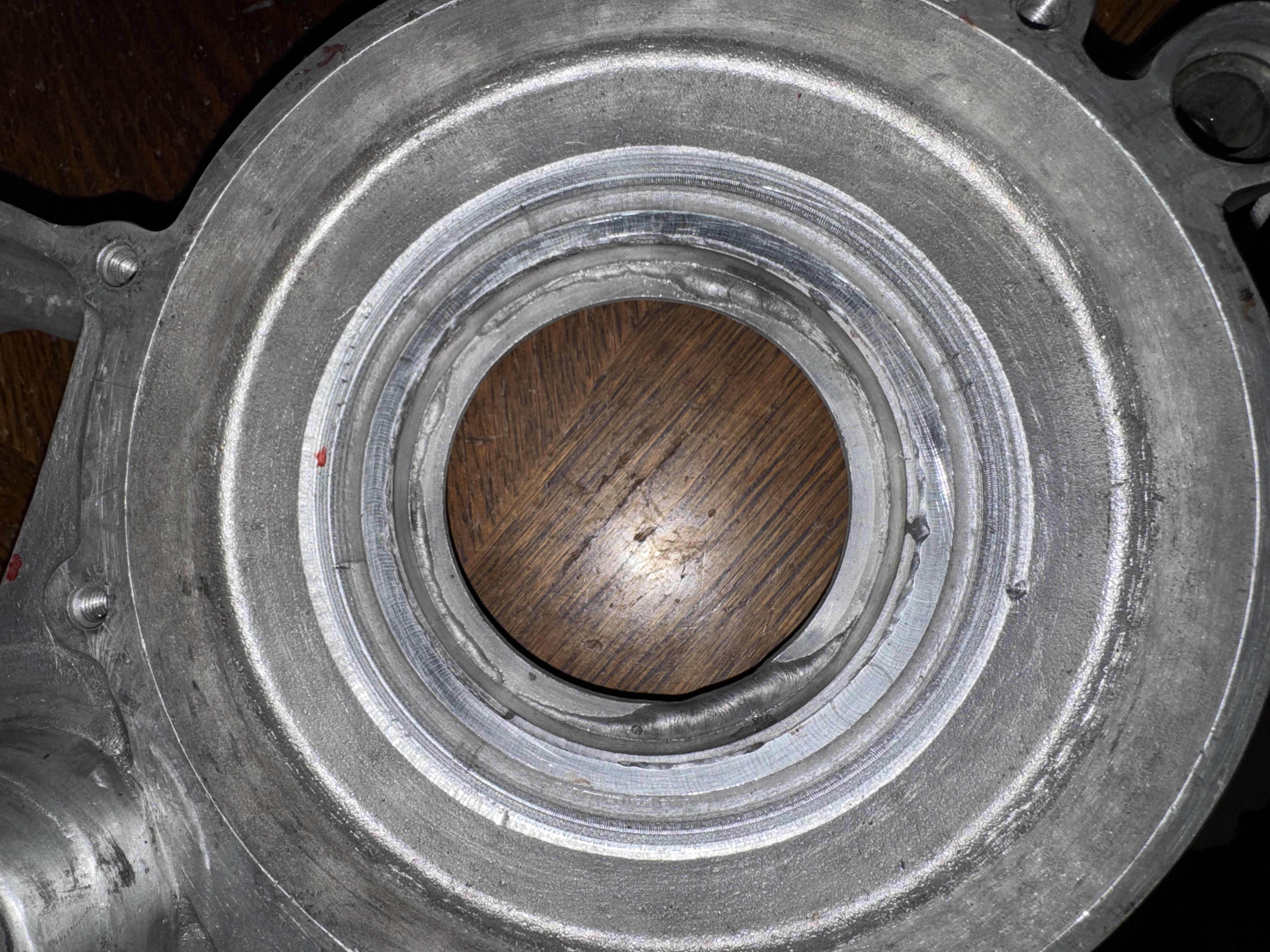

I've now got hold of a mille mainshaft.
There seems to be some room under the inside of the inner clutchcover.
So I'll weld 2.5mm on the inside and some welding on the outside on the outer diameter of the hole.
So I can put a 75x95x12mm seal on the inner cover.

Welding done and heattreated in the oven at 175degrees celsius for 8 hours.
Next week I will machine it in my rotary table.

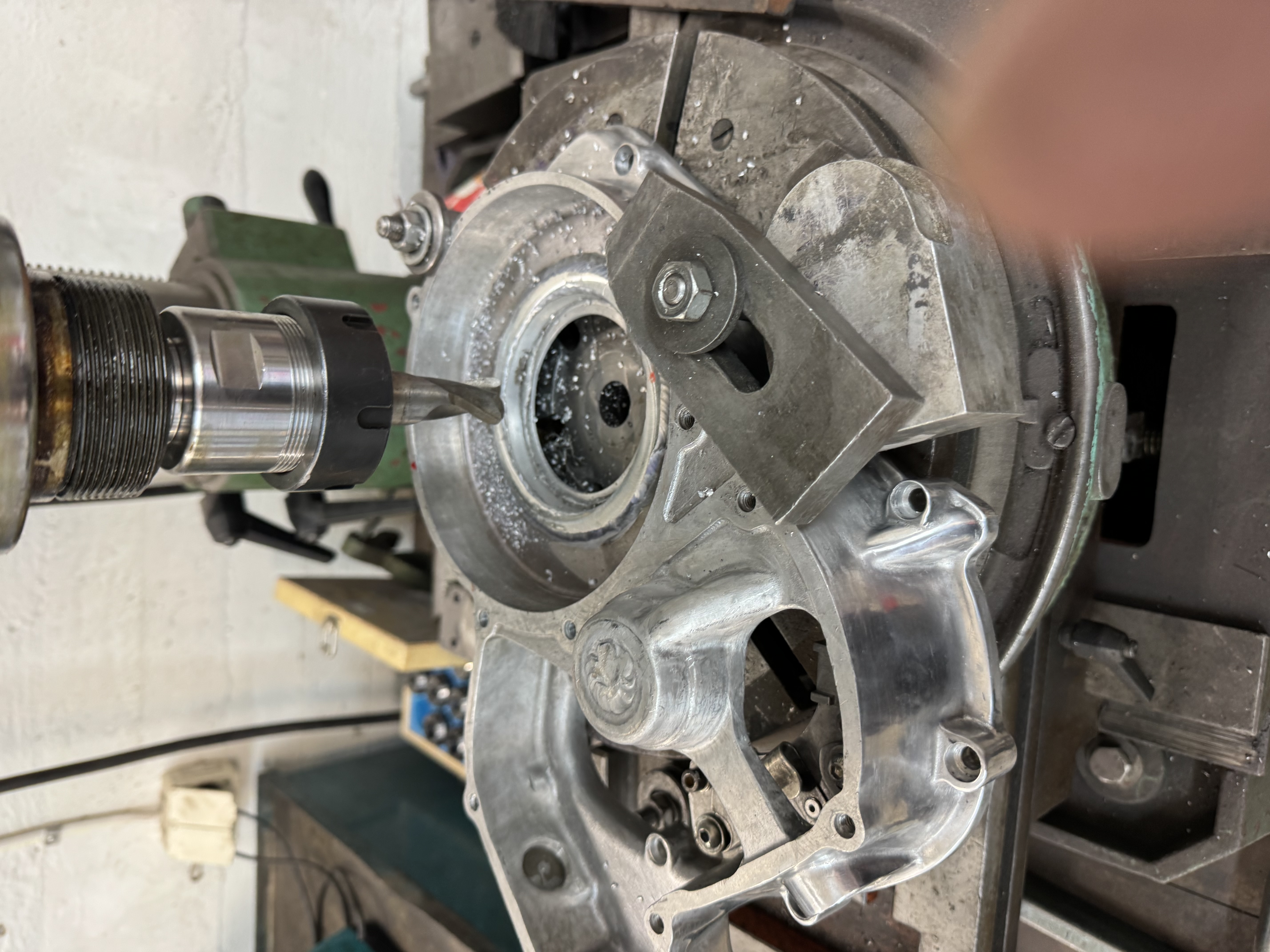

AI Overview
You should not machine the bore to a dimension smaller than the seal’s nominal size; instead, it should be as close as possible to the nominal 95.00 mm, with a slight positive tolerance. Radial shaft seals are manufactured with a built-in "oversize" (they are inherently slightly larger than their stated nominal dimension) to ensure a proper press fit. [1, 2]
According to DIN 3760 and SKF standards, the specified fit for these seals is H8. For an outer diameter of 95 mm, this results in the following bore dimensions: [1, 2, 3]
Minimum diameter: 95.00 mm (0 hundredths below)
Maximum diameter: 95.054 mm (just over 5 hundredths above)
Recommendation
When turning or milling the bore, aim for a dimension 2 to 3 hundredths of a millimeter above 95 mm (i.e., approximately 95.02–95.03 mm). This will provide an ideal press fit, ensuring the seal is held securely in place without becoming deformed. Also, remember to include a proper chamfer (approx. 10–15 degrees) at the opening of the bore to prevent damage to the seal during installation.

First machining in the rotary table, now off to my neighbours machineshop for precision fitting for the seal.
