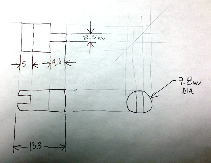

Tach drive coupling piece detail
- Posts: 2393
Here are some photos and a spec drawing of that funky little coupler piece inside your tach drive in case you need to make one...

- Posts: 2393
Re: Tach drive coupling piece detail
Yes Craig, I bet you can figure out why I needed to make measurements of one then.... So I thought, since I had the info, I might as well post it.
Might want to do the same with the Oldham coupler for the shifter box too! They seem to disappear when things are apart for a while.
Amen to both bits!!! Amazing what nooks and crannies they can disappear, or rather, fit into!
