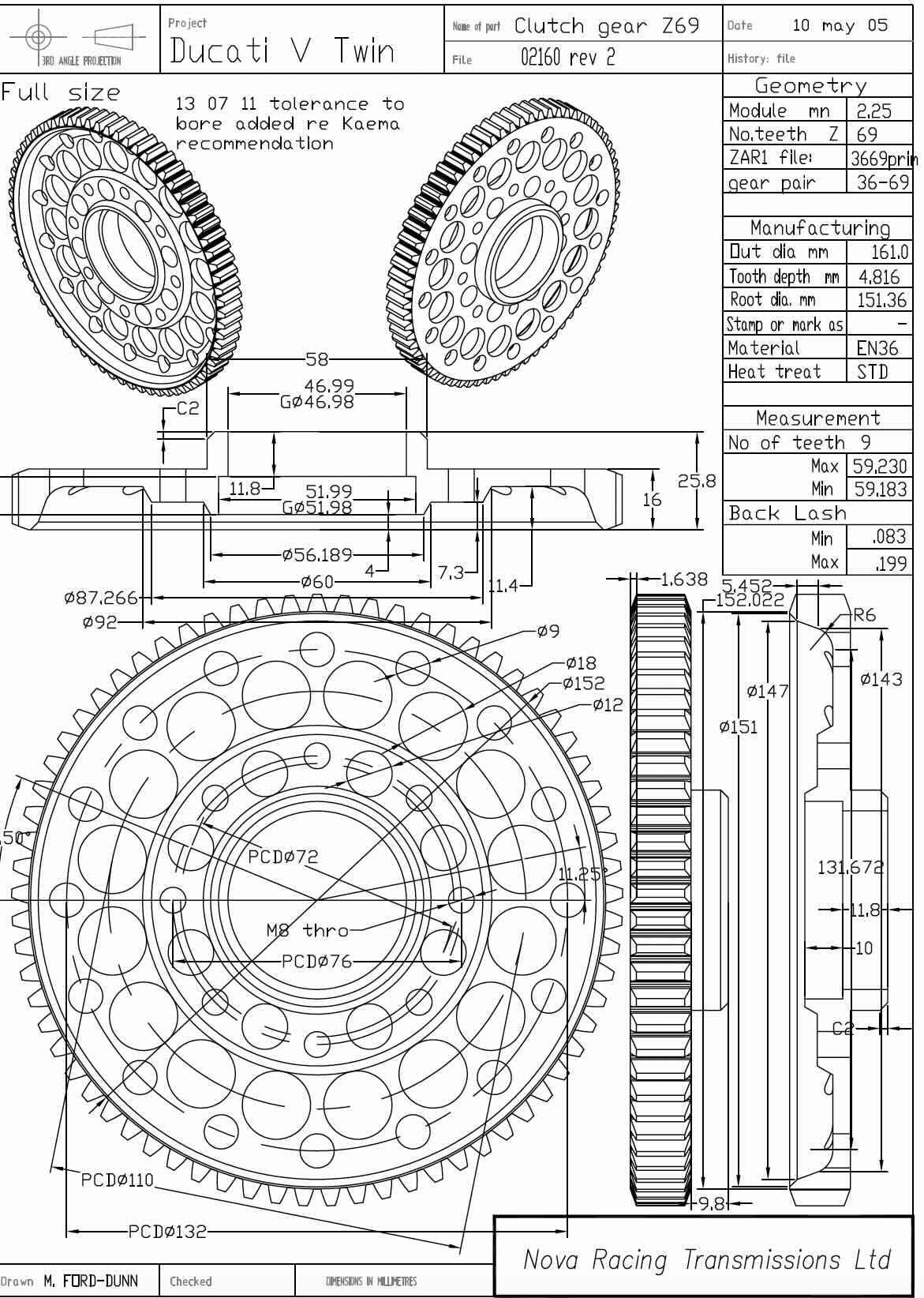

Since veetwo don't have any in stock I decided to make a kit via Nova in uk.
They can start making a kit at the end of this year and the cost would be around 800 pounds.

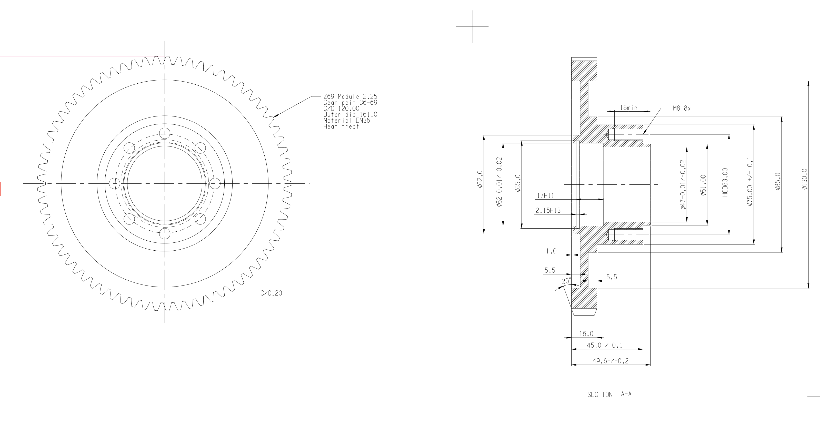

My friend has helped me with this drawing.
I'm going to use a modern Ducati clutch.
I also put in Novas drawings for the wetclutch bevels.
The distance between the the mainshaft and the crankshaft is 120.00mm. On the Darmah crankcases that I've got had a distance of 119.987mm.
I'm still looking for a front gear for the Mille.
If someone can measure it or if someone can lend me one or if someone has one for sale it would be much appreciated.
