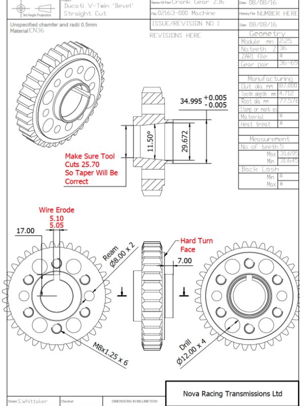

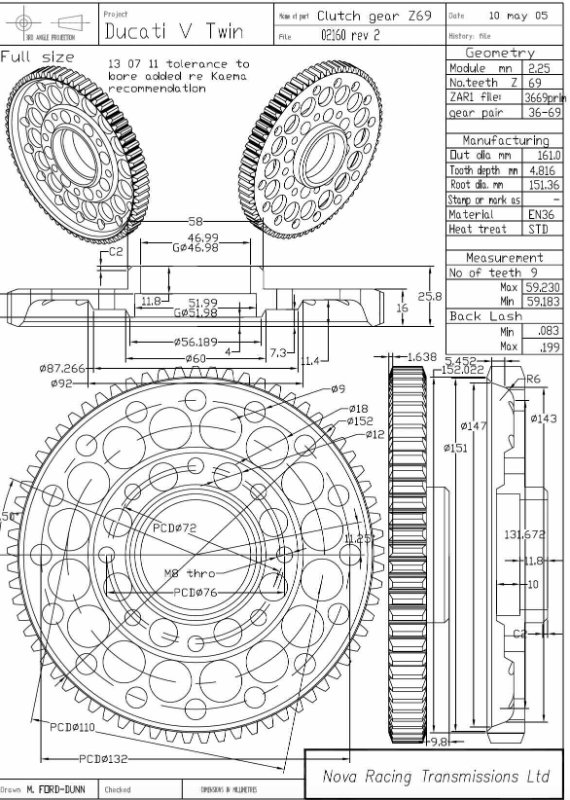

Does anyone know if the gears are at the same place (radially) as on the wetclutch models?
I've got some drawings for the wetclutch, straightcut gears.
But I want to know if the gears are at the same place, i.e is the crankshaft cone at the same place (radially) and has it the same cone 11.5 degrees?
Is the clutchgear at the same place (radially) as on the the wetcluch models?

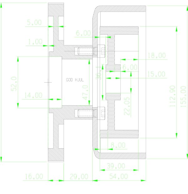

I'm going to put a EVR 48 tooth basket from modern Ducatis.
Enclosed is a draft for this.
