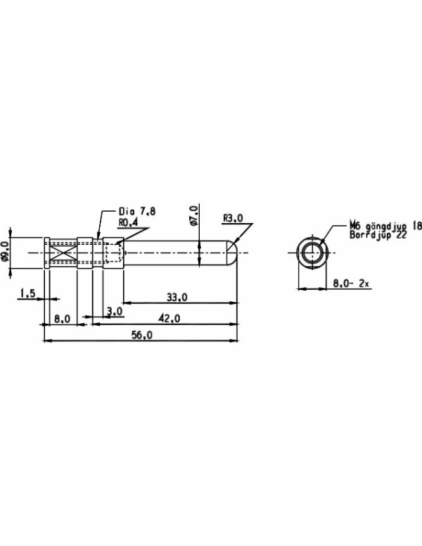

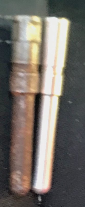

I have made a new brakerod in stainless,that goes into the Rear master cylinder (Brembo PS12)
PART NR 066441300, NR 20 in the link
https://www.ducaticlassics.com/parts/10 ... ake-system
Gängdjup means threaddepth and Borrdjup means drilldepth, in swedish.
A friend of mine made a drawing of the rod if someone wants to make one.
The picture shows the heavily corroded original part and also the new one.
It took me two hours to make it.
