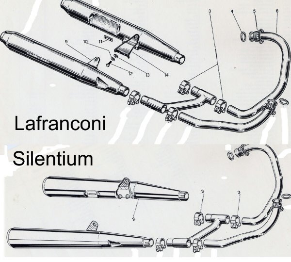

I have 900SSD and have had to space muffler brackets away from frame to stop Conti mufflers from hitting rear axle nuts under suspension travel.
As I have never seen the original mufflers (silentium ?) would I be right in assuming they had an indent in muffler to accommodate the suspension travel.

Yup, as you can see from the attached both Lafranconis and Silentiums have generous indents for the axle nuts.
Dunno what happens with Contis, tho'. Steve should know ...

get some 7/16" ID AN type washers and space the Conti brackets out a bit. Or you can make up round spacers between a quarter and 3/8" long and use those like what came on 900SS....
