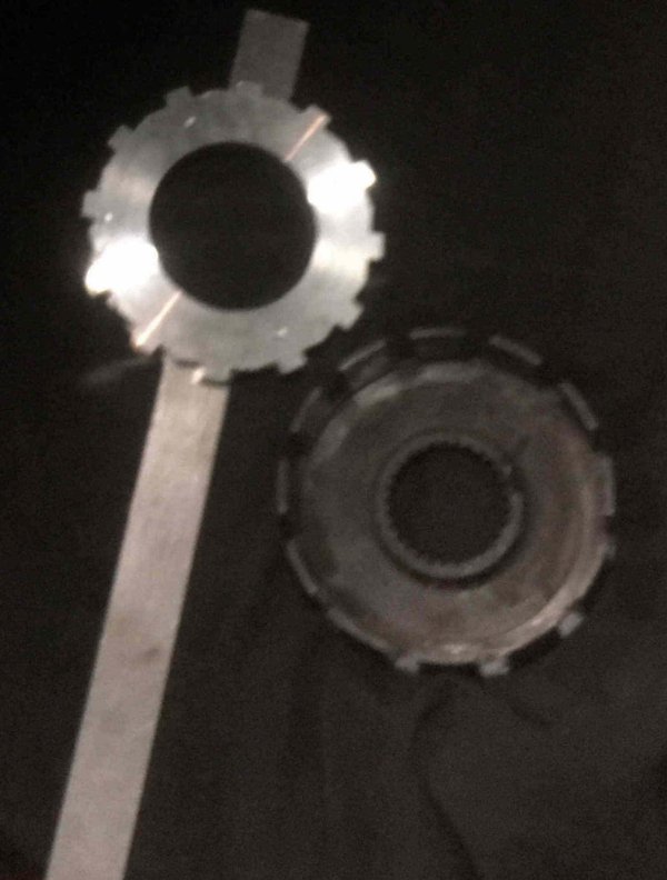

I've made a clutchbasket tool. The inside hole is 90mm, The outer diameter is 161mm and the diameter at the bottom of the 12 teeth is 151mm and the teeth are 13.5mm wide. I locked the big nut with 100nm, the same torque as the clutchcenter since I haven't found any torque for this nut.

looks like it did the job.
