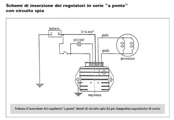

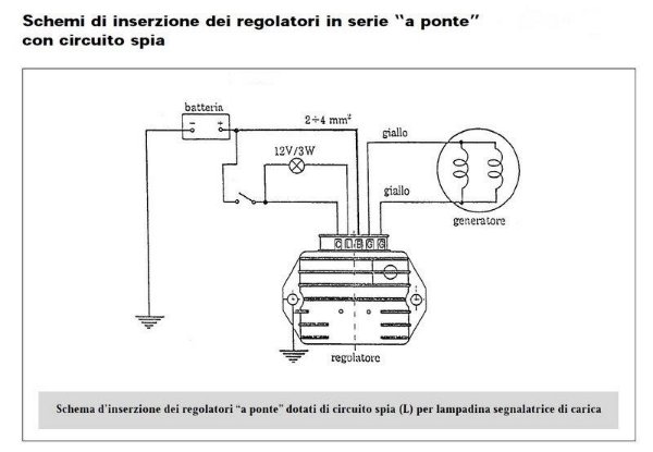

I've purchased a new Ducati Energia 25a reg/rec that fits both the Pantah & the Darmah which has the orange connector and 5 terminals, G, G, +B, L & C.
I've already figured out the two Gs are for the alternator & the +B is for the (positive) battery but I'm unsure what the L & C are for. My best guess is, L for the Light and C is for the switched live i.e. Control.
But it could just as easily be L for the switched Live and C for the Control light :?
These things seem delicate enough without mis-connecting & blowing it up on the first application :( so does anyone know for sure?
Andy B
Re: Another dreaded regulator/rectifier question
Took some time to find, but here's your answer, Andy ...
Explanation:
G = giallo= yellow = alternator x2
+ B = battery positive
L= luce oppure spia = idiot light
C = chiave = ignition switch
It's also possible to work it out from the F1 wiring diagram .. but it ain't easy :shock:
P.s. Also just found this - for a Vespa 125.

Wow! a great fast reply and hopefully useful for others. Top man! :-D -*!^-
I did spend some time trying to find the same but always ended up on sites that required signing up to view the wiring diagram, but that's just what I need - and, amazingly, my best guess was correct.
I won't be using the L terminal mind as I've bought one of the standard charge warning lights from here https://www.improvingclassicmotorcycles ... oducts.htm It doesn't just switch on/off but has different flash sequences for a flat battery & overcharging and switches on if under charging.
