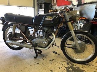

Just a couple days ago I took a 600 mile trip to far away place in northern Maine to buy a Ducati 250 barn find.
I was told it is a 1967 Ducati Diana 250 Mk3 and that it was stored in a barn for about 50 years. It seems to be in pretty good shape and mostly complete.

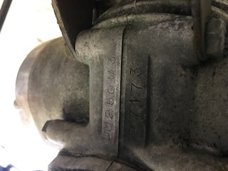

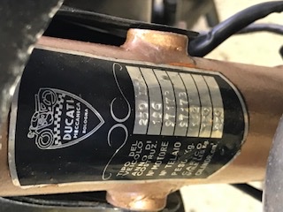

1)exactly what year is it based on the picture of the indentification plate (see pics)?

The engine number 97173 confirms what you were told: a 5-speed 250 Mark 3, also called a 'Diana' in the US.
As to date:
1. The production run of the 5-speed 'Type B' 250 Mark 3 went from 1964 to 1967. However the DM250 M3 prefix to the engine number, plus the later style kicker and footpegs, makes your bike a 1966 or 1967.
2. Numbers for 1966-67 went from 92172 to 104500. However, Ian Falloon has a photo* of what is identified as a 1966 bike with an engine number which, at 100461, is already higher than yours. So, if the dating of that bike is correct, it's possible that yours dates from 1966 too.
Ian also says that in 1967 European Mark 3s started with number 100247.
A further pointer towards yours being a 1966 bike is the round rear light and toggle switch. In 1967, the light was changed to a rectangular unit with no switch.
