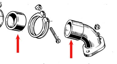

rjk40 wrote: Sat Feb 24, 2018 2:35 pm Still, the spacer/reducer will still not move; maybe I should just work elsewhere.
Comments?
These two pieces, Richard? If so:
Yes, they do get stuck firmly together - it's not just you! - and you're right to proceed carefully. So as Bill said, a bit of heat and a soak in whatever easing oil/lube you have, gently twist back and forward, take yer time ...
The plastic/nylon insulator ring thingy (that's what it is, btw) will often stay stuck inside the carb.
