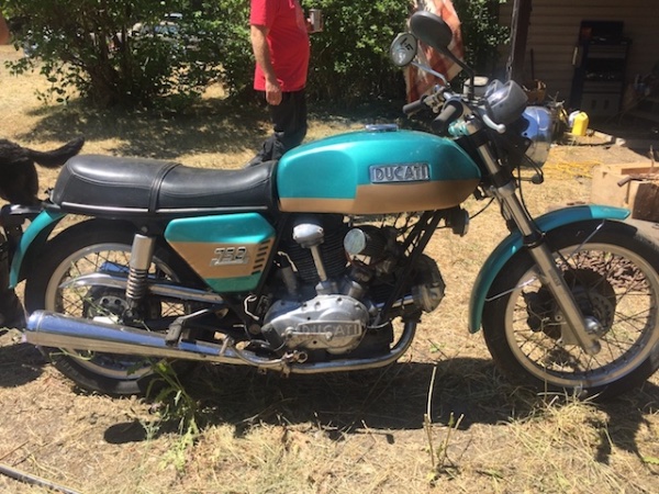

My project bike is a (mostly) complete '74 GT. Read through a couple of books (one labeled a bible and the other a restoration guide) and I think I have a pretty good idea of what it should look like.
Deciding on what it is this thing should become.
Open to suggestions / comments from other 'project managers'...
EDIT: Pic attached...
Getting back to roots...

Welcome aboard, Shane. You gotta love these round case bevel drives. Looks fairly complete and should be an easy restoration for you.
From my perspective, since it is seemingly complete, Id suggest you do whatever you can to keep it in it's original configuration. Clean everything up, mechanically go through everything, paint it as per original and call it a day. When you get tired of it, someone will end up with a nice original looking round case.
That said, it's your bike. If you are going to make sweeping changes, I would still suggest that you don't do anything permanent... Anything removed, clean and store correctly in a box labeled with your bike's engine # etc. Keep note, and keep everything in 1 place.
Above all else, have fun with it.

Heh Shane,
Well, looks like a comparatively straight-forward project unlike the 750 GT basket that I started with. The saga on that one is here:
viewtopic.php?f=24&t=4543
As to originality, as you can see I chose a "season to taste" approach since I planned to ride it a fair amount and hence felt that a number of reliability / rideability mods would be desirable. If you're going through the engine anyway then even though it will add significantly to the cost, in the long run, I'd maintain it's worth it. Also, the electrical system inc. switchgear, alternator, wiring is pretty marginal I think most would agree so there's considerable justifiable improvement there. I'd also recommend Racetech Gold Valves in the front forks and IKONs in the rear. Was never a fan of the original Marzocchis front or rear. Get rid of the points of course. The only things I can think of that I wish I'd done, but didn't is install an oil level sight glass since the dip stick is such a PITA to use. Also my engine cases had horrible porosity as it turned out so if I known that, I would have coated the inner cases with Glyptol and not have had to chase leaking voids.
Other good news is between, Steve / BH, Ducati Classics in NL, Bevel Rubber, Mdina Italia and Columbia Cycle in Nakusp BC, you can source all that you're likely to need.
Anyway, I love riding mine and it's a definitely a permanent member of "The Fleet".
George
Vancouver BC

Hi Shane and welcome to the Forum,BevHevSteve wrote: Fri Aug 25, 2017 10:08 am From my perspective, since it is seemingly complete, I'd suggest you do whatever you can to keep it in it's original configuration. <snip>
I'm with Steve on this. The bike looks relatively unmolested, and you can't 'back restore' originailty.
Enjoy!

Just noticed something ... my wheel stampings (Boranni) are on the right-side (rear) and the left side (front). Is this normal, or has some prior mechanic turned things around?
