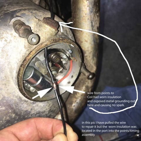

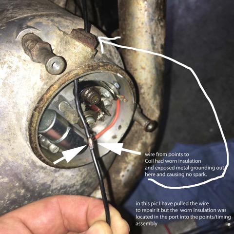

Finally got my barn find running. Cleaned the carb, lined the tank, rebuild the stopcocks, and found a no spark situation. Eventually traced it to the points-to-coil wire having exposed insulation and shorting out inside the case. once repaired, she started within a few kicks but demolished my leg until I retarded the timing and figured out the best starting sequence. Bike only has 6K miles and suspect when it shorted out, bike was put out to pasture, as everything on it seems pretty original. Had to replace a fuse and a bulb too.
Once running, I found the Clutch would not work. Turned out to be 45 years of grime rust and muck sticking all the plates together. simple removed and cleaned and replaced the surflex discs and all is good.
This weekend I finally took her for a ride- and got into 2nd gear but rear brake is stuck and I need to address that. didn't want to push my luck with no rear brake. But the bike sounds fantastic, and pull strongly up the hill in front of my house. attached a few pics.
