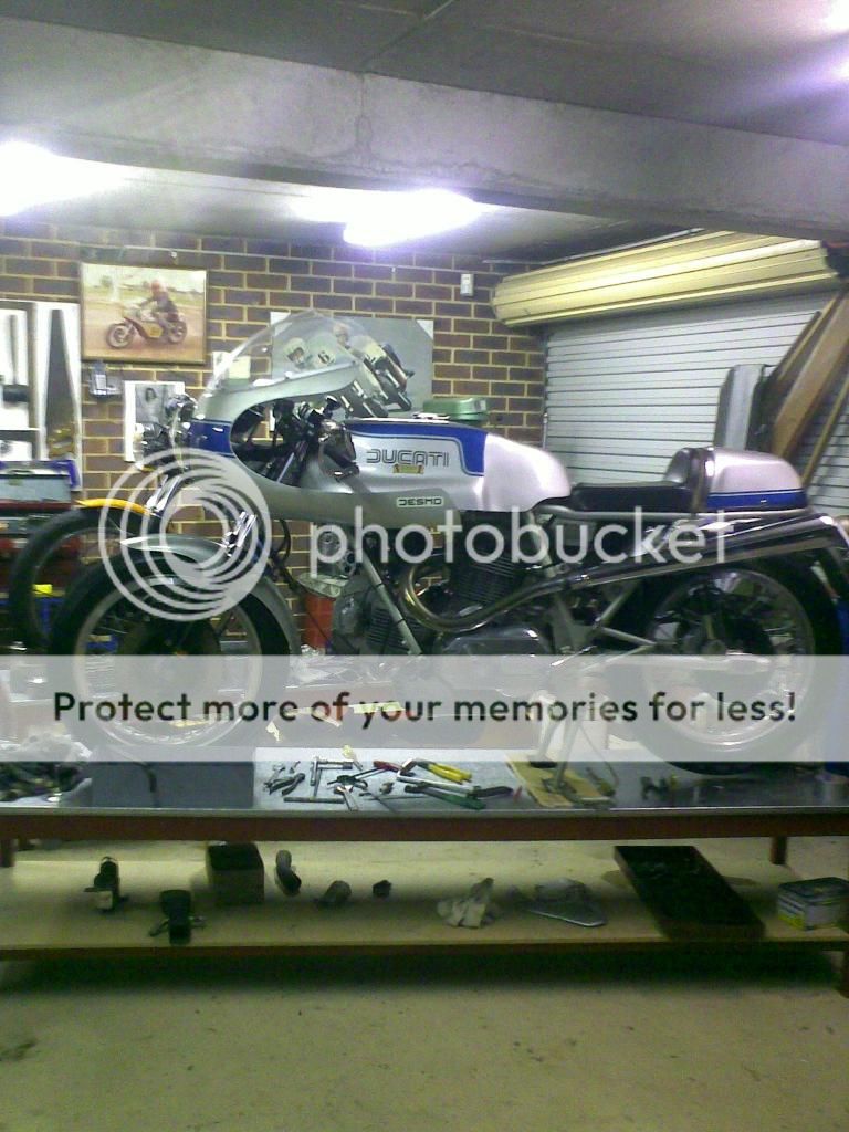

Here's the 75 750 SS with high pipes. They are standard SS Contis on the headers...
btw...This thing barks like a dog and goes like stink...and the extra clearance down below can be handy if you're feeling brave! :))

Thanks Kev, thi is getting me closer to what Im seeking. So, the standard contis fitted without issue? Do they mount to the shock mount bolt?
I will be fitting possibly my pipes(megas) from the NCR pipes I think, will just check the lengths are the same.
On the 75 SS, yes and yes. (one other piece of advice from personal experience...be careful reaching over from the RHS when setting idle on the rear carb with high pipes....kinda hot around there!)
