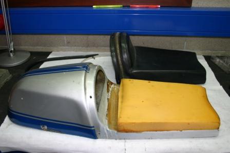

Re: 1978 900SS - solo seat upholstery design
Hi,
I've just recently had this done for my '75 SS, I think the '78 solo seat is the same, but it's worth checking. The original upholstery is laughably simple, two blocks of rubbish yellow foam and a black vinyl (?) cover which is glued to the seat base. The only sophistication is the cloth/metal zip that joins the vertical bum stop part to the rest of it, allowing access to the hollow seat hump. This part is held down by a chromed steel strip screwed into the hump with 4mm countersunk, slot head screws. I'm being a bit vague because I'm not even in the same country as my bike, and can't remember the exact details, but will post some pics when I find them. I have the original cover, and can post dimensions, but only when I return to 'the garage' at the end of November. Any competent auto upholsterer will be able to knock up a new cover and foam although complete kits are available from 'Old Racing Spare Parts' in Italy, possibly Damien 'Bevel Rubber' in Aus, and our host and excellent friend Steve at Bevel Heaven in California.
I'll try to put together a useful post with links and pics when I have time...
'75 900 SS
here is a pic of '75 solo seat components. The vertical part of the cover contains another block of foam and a rubber stiffener. let me know if this helps/and or you need more pics
