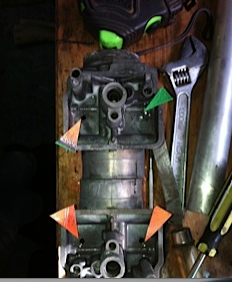

I have a set of PHF30 carbs off a GT750. After removing the bowl and float and tipping the carbs upside down there are two holes about 1/8'' dia and 2" apart. On one carb these are open and the passage leads to the outside top.The other carb has one hole blocked by a lead plug. Question is should all holes be blocked or is what I have correct ? in photo orange holes open, green blocked

Looks normal for me...

G'day mate,
With Steve on this one. Normally only one is open to air with the other plugged by lead but I have seen a couple with both open. I fact I pulled apart a set of carbs last week for a bloke who brought his sick Darmah over to get sorted and it had 2 holes open on the front carb and 1 hole open on the rear and no evidence of any lead plug having been fitted in either of the empty holes.
Bike tuned up nicely after a good carb clean and proper set-up.
