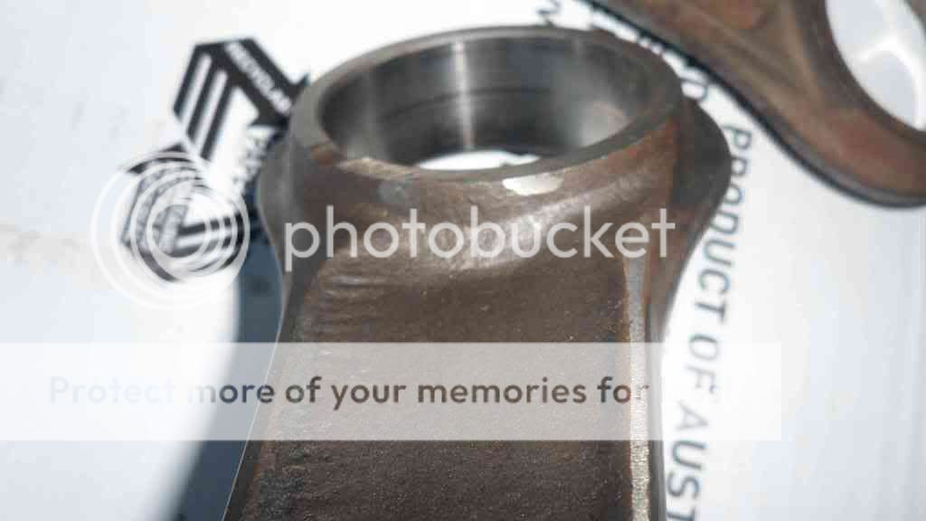

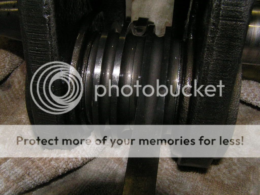

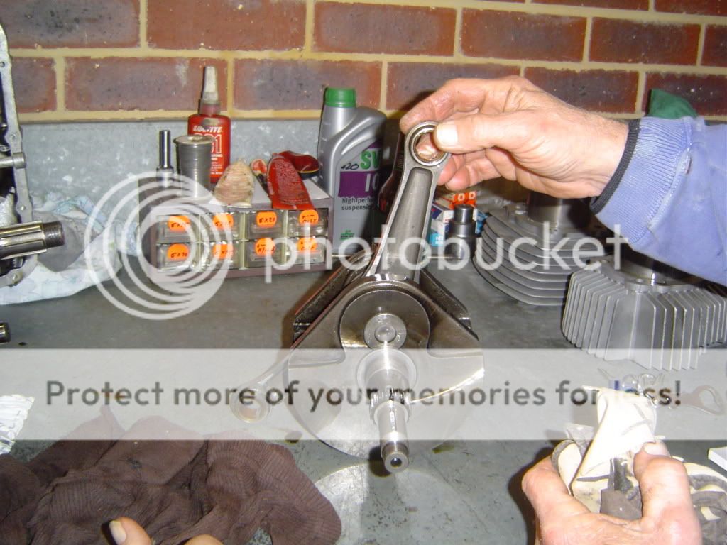

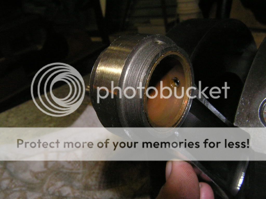

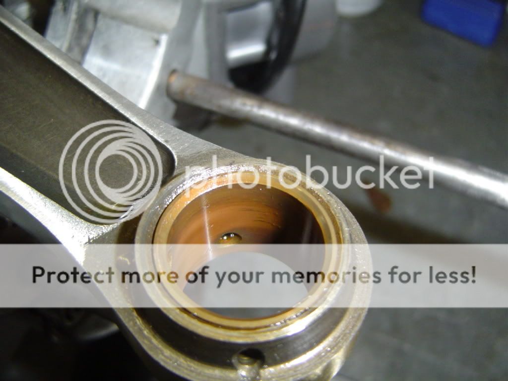

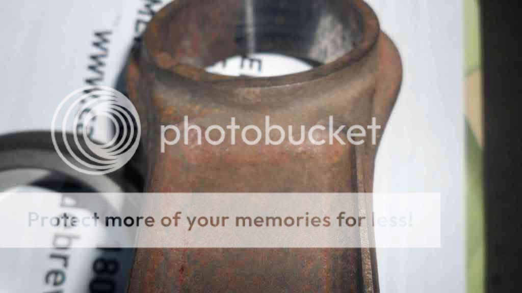

Took some pics of the various rods...So this first pic is an old style GT rod. Note that is is just forged and cleaned up, minimal machining on the webbing...
This one is a Sport rod. Note that it is machined on the flat and the side of the webbing.
There is also a different webbing at the small end. Later GT con rods may look the same as the sport, I'm not sure. The Sport rod is on the left, GT on the right.
Sport rod...
GT Rod...
And it wouldn't be complete without.....Greenframe rods...
Hope that helps.
