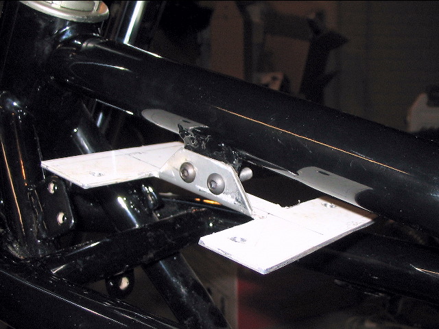

If Dyna's are fitted, how is the mounting setup?

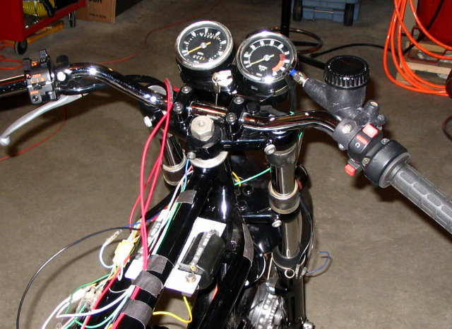

I made a pretty simple "H" shaped bracket and put them under the tank. there is barely enough room for them so you have to make it as tidy as possible and maybe tweak the angle they're mounted at a little.Phactory wrote:
http://www.teamyikes.com/RC/roundcaseprojecf.html
