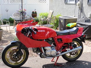

best solution was to replace cap. Thanks Steve and others for suggestions.
Steve thanks for customer service and getting new cap out for me.
Hope I've enclosed picture so you can see my work in progress.
Have screen on and lower fairing is done just like the look without it.

Re: Fuel weeping
looks good, glad to help.
