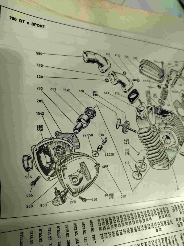

I know that a few pieces are required to link the angle drive to the camshaft inside the bevel head, according to the spare parts catalog:
They include :
- a small slotted disc (92.050) ;
- a bush (49.240) ; and
- a cross pin (98.030), which looks to be the main piece to transmit the rotation.

That last picture you show with the bevel cover removed appears to be the vertical head.
The mechanical tach drive is driven off of the horizontal or front head cam.
The vertical head has no provision for driving the tach.
The parts diagram shown is of the horizontal head. The parts you indicated would be needed to drive the tach cable and most likely are not there if you have an electronic tach.

Thank you, the answer I expected!
Yes indeed the picture corresponds to the vertical cylinder head cover that I had removed to install a glass cover.
I thought however that the two cylinders were alike as they do not show any difference of the camshaft ends in the parts catalog (difficult to see the details in the drawing but apparently the two camshaft ends only have a sided slot...):
When I disassembly the bevel cover of the horizontal cylinder, I hope that there is that required central slot at the end of the camshaft!

When you remove the horizontal/front cylinder cover the cam end should look like the rear/vertical cam end.
You still will need the three pieces/parts shown in the parts diagram to assemble on the cam end to transfer rotation to the tach drive.
What I don't know is if Ducati assembled all of the engines with the parts needed to mechanically drive the tach then simply wired them for electronic tachs leaving the mechanical parts in place.
All of that said, if the front cam end looks like the rear cam end you'll need the three parts.
