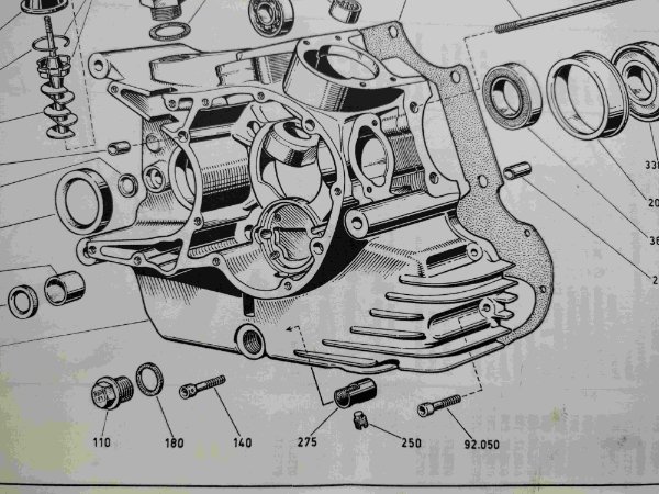

I would like to understand in particular if I need to unscrew that "grubscrew" when, during my next oil replacement, I have to remove the oil filter for cleaning.
Looking at the parts catalog of the 750 GT it is not clear to me how exactly the oil filter (part 125 800 49.800), inserted from the LHD side of the crank case:
is secured in the facing rubber (part 275) introduced on the drain plug (part 110) on the LHD side of the crankcase:
Does this grubscrew (part 250) secure the orientation of the rubber and/or tighten the oil filter on the RHD side of the crankcase (in order to allow a full oil flow upstream through the oil pump)?
And is it necessary to secure the screw with blue Loctite or alike?
Please any answer appreciated
Re: 750 GT oil filter grubscrew
the grub screw locates into a hole in the rubber sleeve that the sump screen nestles into. You would never remove that grub screw unless the rubber sleeve falls apart and needs to be replaced. It also acts to make sure the rubber sleeve is oriented in the proper position so that oil can actually make it from the pump into the sump screen IOW rotate the rubber sleeve into the wrong position and no oil will pass through the sump screen. The grub screw is peened at the factory so it can not back out on its own.

Thank you very much, Steve.
That is what I thought but I was unsure about its required removal for oil change.
Now it's clear! :-D
