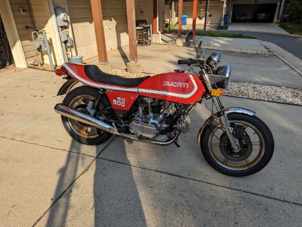

Hello! My name's Matt and I live in Northern Virginia in the US, a little ways west of DC. For a living I'm mostly on a computer, but in my spare time I enjoy working with physical objects and making things fit together and work just right (hence Ducatis, very satisfying to set them working just right!). When I was looking for my first bike I got interested in desmo Ducatis, and after owning and working on a couple of more modern Ducatis for a few years I started wanting a classic desmo Ducati to learn about and maintain, especially one of Ducati's first desmo V-twins. I didn't want to feel guilty if I ended up putting a fair number of miles on it, so the 900SD seemed ideal and I finally managed to pick up a 1978 Ducati 900SD Darmah at auction back in July.

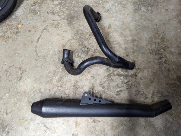

I've only been riding on the street since 2018, but also have a 2006 S2R800 (my first street bike, still my favorite daily) and a 2013 Streetfighter 848. I've done the usual things like valves, belts, fork rebuilds, and electrical work on both of those, but the bevel driven cams and even just 4 stroke carburetors are a new experience for me. I'm embarrassed to say I only knew some basics around the early desmo Ducatis and looked at the few recent 900SD auctions I could find to see what it seemed like they were going for, so I really didn't have much criteria beyond "900SD, good condition, reasonable price". The previous owner had it for 43 years and had some paperwork and parts to go with it... it has some modifications, but seems to have come with most (all?) of the original bits. It also came with an unmarked black 2-into-1 exhaust system that the previous owner said he had installed, then immediately decided it was too loud and had the Silentiums put back on. I've had trouble finding anything on that exhaust system. I happened across a video on YouTube where a guy was starting a 900SSD that had an identical-looking exhaust... I asked him about it and he said his was also unmarked and was made by Nepoti Caracchi Racing, so maybe that's what it is!? Less than a month after picking up the bike I found some lightly scratched/dinged early ~1980 Contis on eBay and the seller said they came off a Darmah he used to own. They basically just needed a little touch up sanding of isolated scratches and then general clean up and polishing to make them hold up to anything but a very close inspection, so they seemed a steal at $500.
The brake calipers were recently rebuilt, calipers themselves look nearly new as do the steel braided lines. The engine looked very clean, but the first time I took it out and then parked it in the garage it was dripping just a little oil from somewhere at the back of the rear cylinder, so I'm sure it was just cleaned up for the sale. I knew it had an aftermarket Derale oil cooler, but I hadn't even realized the other modifications made along with that, i.e. the oil filter cap has an oil line coming out that goes through the cooler, and then after the cooler the line branches off to the center of each of the cam supports. I didn't notice until just this week that the cam support is usually just a flat surface on the outside and that either the stock ones were modified or these are aftermarket ones with oil fittings. It runs reasonably well overall, but the idle is a little rough and it's become noticeably harder to kick start, especially when it's hot.

NCR Exhaust!?
NCR Exhaust!?

Shortly after I got it, with Silentiums

Interesting story, interesting bike. I don't recognise the exhaust-silencer combo, so can't help you with that. But looking at it, I can see why no-one would want it on a street bike. Contis are already loud enuf ...

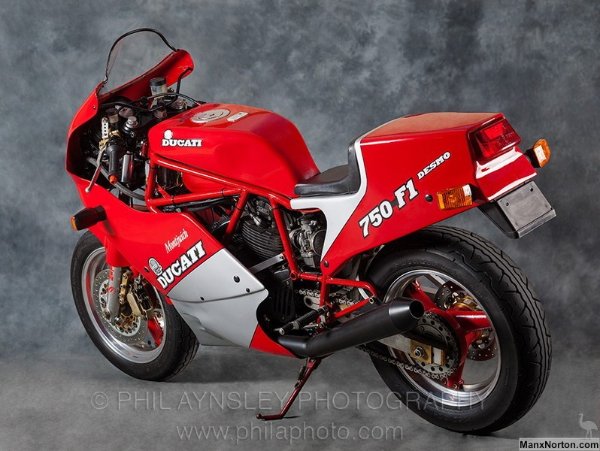

The exhaust could be a Verlicci.
Pics are hard to come by.
A friend of mine had a Verlicci on his 750F1B. The sound was incredible.
Closest I got was a Phil Ansley photo.
