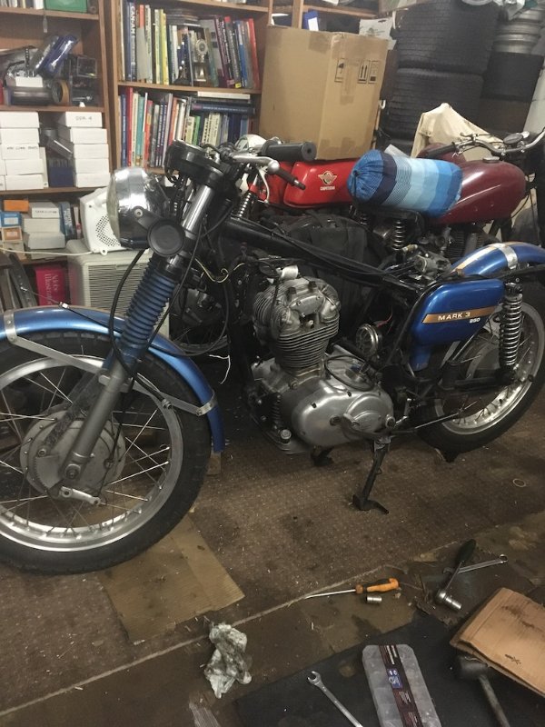

Greetings.
My 1975 250 Mk.3 is going back together. I bought it around 2000 and it suffered big-end failure almost immediately. It was a really nice bike - very clean throughout - so I wasn't completely gutted. Twenty-two years later the engine is bolted in and I'm going out shortly for a new battery and fuel hose. The tires will do for now.

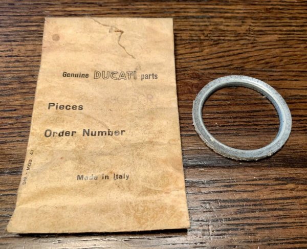

What is a Ducati exhaust seal like? Do they do well with the modern style of collapsing copper thing or is a simple annealed copper ring good?
What's the original Ducati part like?
There was none in it when I took it asunder.

Re: 250 Mk3 reborn - Exhaust Seal?
The Real Thing is a U-shaped ring of aluminium with an insulating filler. Plenty of pictures out there on Tinternet, for example at Ducati Vintage Store or Lacey Ducati. Here's one:
But no reason not to use a hollow copper ring is you so wish. I see that's what Eurojamb offer:

Re: 250 Mk3 reborn - Running!
I'm very happy to report that the 250 Mk.3 is now running perfectly.
It initially wouldn't start but flipping the Lucas Rita doofor 180º allowed it to fire up on the very next kick.
In the end, I assembled it without an exhaust seal as the threads were a bit worn and wouldn't start with the thickness of seal I had available. I may cut out a thin copper gasket for it but am reluctant to overstress the threads.
Anyway, it's a nice afternoon and I'll give it a gentle ride out.
