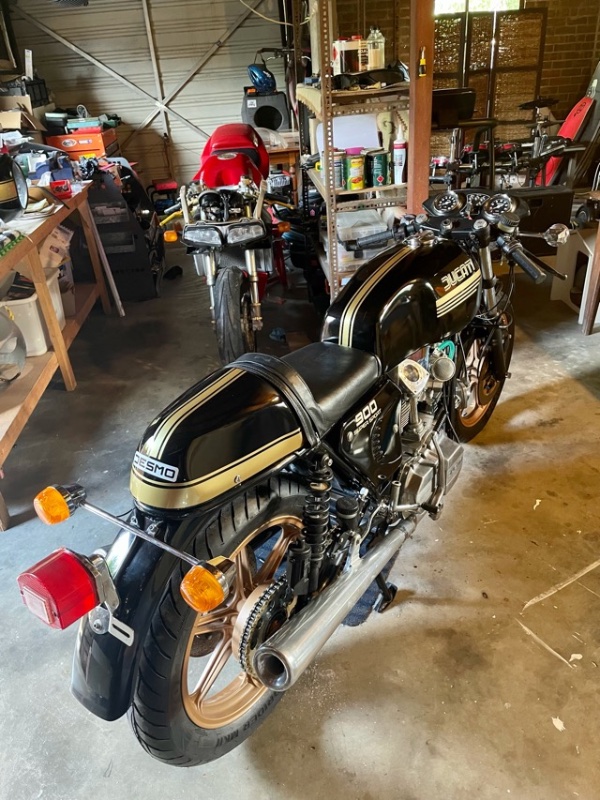

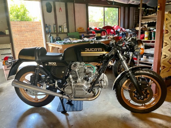

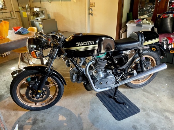

HNY! Thought I’d post an update to my 900SS restoration which is almost complete.
I am having issues with getting it started. So far only a few backfires and some savage kickbacks. Kind of wishing I went with an electronic ignition to avoid all the bruises.
I’m guessing it’s a timing issue so will take it to a pro for a final look over. I was hoping to get it started, would have been a nice way to finish the project. Any ideas are welcome.
Also, any tips on getting the center stand spring on? I’ve already stretched one out of shape trying to get it on.
Here are some progress pics.. cheers!
Restoration almost complete. Won’t start
