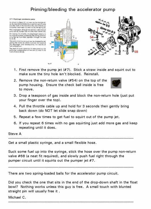

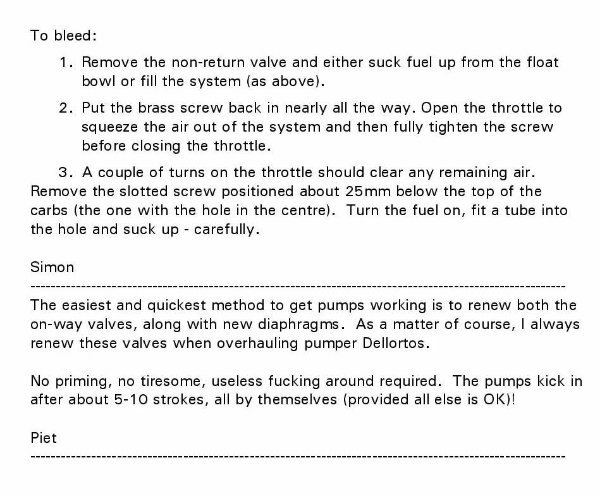

Re: PHF32 Accelerator pump No Pump...
Hi Kara,
More than you'll ever want to know in the two docs attached
