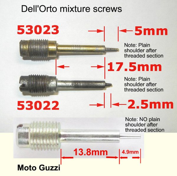

When you say the mixture screw is longer.you mean physically.If that is the case you have the wrong mixture screw.I would say the shorter one is correct.I raised this on the forum before.

Yes, the taper section is visibly longer. (Estimate 0.5mm.) Inspected both under magnifying light thinking that shorter one may have tampered with but appears to be original.
Correct me if i am wrong but the mixture screw on these carbs adjusts fuel flow.
Searching forum suggests that screws should be wound out between 1.5 & 2 turns as a starting point. The original rear carb is happy within this range, the front carb with shorter screw (which appears to be running rich) will presumably require less turns out.

mdal8798 wrote: Mon Jul 20, 2020 12:53 am Yes, the taper section is visibly longer. (Estimate 0.5mm.) Inspected both under magnifying light thinking that shorter one may have tampered with but appears to be original.
There are at least 3 versions of the PHF/PHM mixture screw, 2 of which you can find on Bevels - see the picture below, with thanks to Steve A for the info on the top two.
I'm reasonably confident in saying that if you have AD/AS carbs, you should have the shorter ones. If you have CD/CS carbs, it should be the longer ones.
Me, I'd want to have a pair of the correct ones. For you in Oz, Mark, Phil Hitchcock at Road and Race in Sydney (amongst others) should be able to supply.
mdal8798 wrote: Mon Jul 20, 2020 12:53 amCorrect me if i am wrong, but the mixture screw on these carbs adjusts fuel flow.
Correct. The strength/weakness of the air-fuel mixture is determined by the air drilling at the front of the carb and the size of the idle jet. The screw regulates the amount of this mixture.
mdal8798 wrote: Mon Jul 20, 2020 12:53 am Searching forum suggests that screws should be wound out between 1.5 & 2 turns as a starting point.
Correct. That should get the motor running. After that, a bit of carb balancing/tuning may - or may not - alter it slightly.
