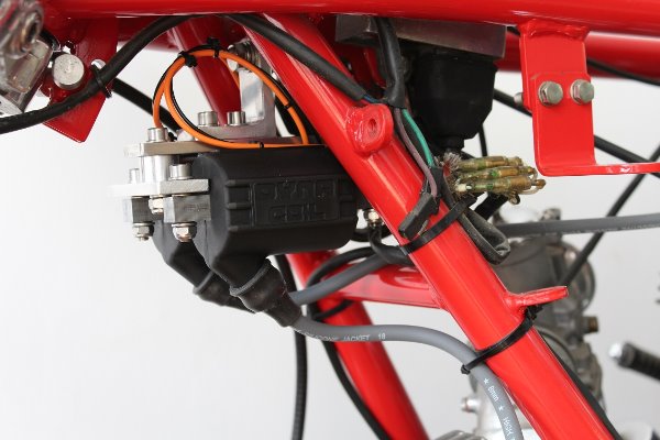

Posts: 172
Re: Fitting Dyna Coils to 81 MHR.. Ballast Resistor Needed?
Initially, reused the old Ducati frame and planned to hang the coil block from the old Bosch frame plates but changed my mind and made a hybrid bracket; still uses the cradles from the old Ducati coil frame but mounts roughly in the middle under the tank with one coil feeding forward and the other backward:
Post by geodoc »
Very tidy. Nice touch with the red ty-wraps.
