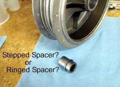

Hi All,
I know that Steve's sketch of spacer in sprocket carrier is for disc brakes, and since I have a drum, I ask for clarification on a certain spacer.
See the three pics at:
https://www.flickr.com/photos/124760992 ... 2723190952
The first pic shows the ringed spacer in the orientation of which it was removed after bearing removal from the brake drum . I believe that this is correct, but a lot on this bike has not been per factory.
The second pic shows the "headed" spacer in between bearings in the sprocket carrier (old bearings shown for reference), with the headed end pointing away from the sprocket, and with the small spacer in between the bearings, slid over the headed spacer. Leftmost is the spacer in question, has a "stepped" hole, the larger end of which fits nicely on the non-headed end of the headed spacer. It would seem to be where it should rest, but I cannot visualize it after the bearings are in. Any help is greatly appreciated. Craig, I'll buy you another dinner if you can help.
The third pic shows the stepped hole on the mystery spacer in closer detail.
Since Steve's sketch of the sprocket carrier assembly is for disc brakes, I seek clarification on the location of the mystery spacer before I press in the new bearings. The 860GT parts manual is not clear on the shape of these spacers, as many of you know.
Thanks kindly in advance.
Richard in Florida

I am sad to say that the pieces do not fit as I had assumed:
When I position the headed and stepped spacers in their supposed "would be" position once the bearings are installed on their flats, the headed spacer's "head" protrudes over 1/2 inch from the sprocket carrier, whereas 9:2f in the Haynes clearly shows the headed spacer flush under the bearing's flat washer.
When properly positioned without the stepped spacer, the headed spacer fits perfectly into both bearings, flush. I'm beginning to think that I am either going loopy or that I have a spacer that maybe belongs elsewhere. (????)
Three spacers are involved, per my Flickr pics:
1. The headed spacer, which will reach perfectly flush through both bearings when installed
2. The unstepped spacer, which fits perfectly between the two bearing flats, and which slides over the headed spacer
3. The stepped spacer, which throws a monkey wrench into the mix.
Without the stepped spacer, the unstepped spacer properly sits between the bearings, as does the ringed spacer in 9:2d for the other part of the hub, so I am really unable to find a home for the stepped spacer.
Sadly, the parts manual, as you agreed, is harmful to reality; sometimes mislabeled as "mystique"; my 1969 Norton Commando certainly had some of that, like a leather clutch plug washer and Whitworth threads, neither being common here in the U.S. colony.
I am bewildered, still seeking an answer, but I do appreciate your research, and when the mystery is solved will heed your recommendation on the order of reassembly, once I recover from the embarrassment of not taking adequate pics on disassembly.
The quest for enlightenment continues....
Richard

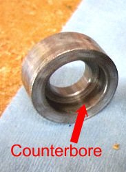

Re: 860GT Rear Wheel Drum Brake Spacer Quest for Clarification
Ok, got you, Richard. (FWIW, the technical name for that feature is a 'counterbore').rjk40 wrote: Fri Jan 25, 2019 6:51 am <snip> the stepped spacer is in the Flicker pics, and is the lonely orphan ... <snip> )I'm just really bamboozled at the presence of that durned stepped piece <snip>
Still mystified as to where it came from/where it goes ...
(Altho' even that question engenders another: why would it be counterbored?)

Thanks for the comments, Gentlemen.
Craig, I had forgotten the term "counterbore" as I had not used the process or such a piece of hardware for a long time.
Vince, I am the original owner of the bike, bought it new, and there were never any wheel swaps. There have been some anomalies elsewhere, such as a quite different number of clutch pushrods: 11 instead of the usual 9 or 10 (Craig, you likely remember my thread on this...).

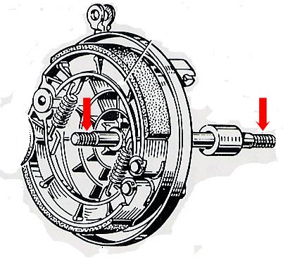

Since I have the proper spacers that fit in between the bearings on both parts of the wheel hub, as well as the same for the front wheel , I can safely proceed install the new bearings and spacers. The orphan certainly does not go in between bearings.
Looking at the questionable drawing in the 860GT parts manual, the rear wheel has three distance pieces:
- # 190 goes outside the wheel assembly between it and the swingarm
- # 185 appears to sit outside the wheel assembly at the sprocket, and it is not clear to me which piece of mine relates to it. Maybe this is the mystery piece.
- #480 is called a distance piece, but in the questionable drawing, looks more like a sleeve.
Again, I hope that one of two things will happen:
1. When I re-assemble it after installing the bearings, all will be well without the "orphan", or:
2. It will become evident as to where the durned thing lives.
Until then, I will continue kicking myself for not doing better 30 years ago at disassembly time, in the documenting of said parts, and still seek an answer to an unsolved mystery.
Richard

Hi Richard,rjk40 wrote: Sat Jan 26, 2019 7:00 am <snip> Looking at the questionable drawing in the 860GT parts manual, the rear wheel has three distance pieces:
I think you may very well be right. I kinda assumed that you had the wheel spacers 'put aside' somewhere - i.e your 'stepped spacer' wasn't one of them. But that was an assumption I had no right to make.
Also: I checked up on your 'stepped spacer' with a 750 expert. He said, "I have never seen that part before". And guess what? The 750 doesn't have that kind of wheel spacer ...
Maybe this may help
Thanks again, Craig,
# 185 may well be the mystery spacer. Too bad the picture of it in the parts manual is so mediocre; it certainly doesn't show a counterbore, even though it could well be that way.
When I disassembled the bike thirty years ago, I kept the pieces loosely grouped by category (engine, tranny, wheels, frame, etc.), so the mystery continues. Then again, this bike has been anomalous in other ways (kinda like the 1975 factory just threw parts together.....).
Once I get the rear wheel assembly together and sitting in the swingarm, it will become evident, hopefully, that the part is truly an orphan and/or that I have also become loopy. If the pieces all line up properly, the sprocket tracks the chain in good alignment with the primary sprocket, and the other side brake cable and torque arm are also lined up properly, I shall the retire this orphan to my "hall of horrors", which has had such items as 1969 Norton Commando valve guides, a transmission mainshaft in two pieces, and a leather clutch plug washer all from same same beast. If there is space on the left side to be accounted for, then the mystery is solved if I can get the orphan to reside properly there.
Also, I really appreciate your checking with a 750 expert as well.
At least it has been deduced that I have the correct spacers that reside between both sets of rear wheel bearings, thus I can proceed to press in the new sealed bearings. Then, on to the next challenge.
Best Regards,
Richard

Hi Ducadini,
The spacers that go in between the two triangular spaces is established; they each meet perfectly with the flats that the bearings sit against, thus they will properly function.
The large spacer (# 190) sits between the brake drum and the swingarm.
No spacers of mine have any threaded ends.
I am installing new bearings from Steve at Bevel Heaven (6, two for front hubs, and 4 for the rear...); all are sealed bearings.
Hopefully all will become evident once I have installed the bearings and reassemble the rear wheel assembly.
Thanks for the info.
Richard

Gentlemen,
I may have deduced the answer to my question and hoisted on my own petard as a result.
The "mystery" piece, now likely identified as #185 in the infamous 860GT parts manual, has an outside diameter that exactly matches the outside of the inner race of the sprocket bearing(s). This would make sense, as it will keep the bearing from contacting the inside of the swingarm on that side. I hope that this is true, as it makes sense, and I cannot find any other way to keep that bearing from colliding with the swingarm inner face on that side. Hopefully, the chain will then track properly on both sprockets, and the wheel will spin nicely on the axle when mounted into the swingarm.
I will likely be pressing in the new bearings on the morrow, and shortly thereafter will be assembling the unit to temporarily store it back on the swingarm until I get the new spokes and rims. If all works, you will likely hear (even from thousands of miles away...) the sound of me hitting my ever-flattening forehead for being so inept at documenting things in the past.
Thanks to Craig, Vince, and Ducadini for your efforts.
Richard (semi-lucid in Florida)

It might also explain why it's counter-bored. Are the ends of your axle, the threaded part, a smaller diameter than the unthreaded length? If they are, you may very well find that they fit into the counterbore of the spacer.rjk40 wrote: Sun Jan 27, 2019 11:09 am The "mystery" piece, now likely identified as #185 in the infamous 860GT parts manual, has an outside diameter that exactly matches the outside of the inner race of the sprocket bearing(s). This would make sense, as it will keep the bearing from contacting the inside of the swingarm on that side.
Just a thought ...
