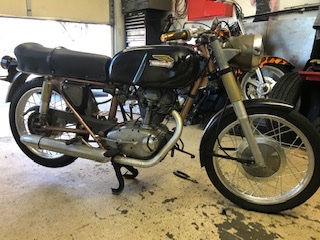

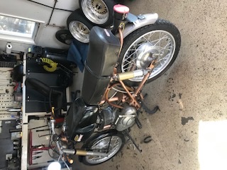

Hello,
I just introduced myself in the above introduction section and posted few pics of my newly acquired 196? Ducati 250 mk3.
My first two questions are:
1) what is a good cylinder compression test figure for the 250 engine?
2) which engine oil should I use?
Thanks to all
Vladimir in Wakefield, MA USA
