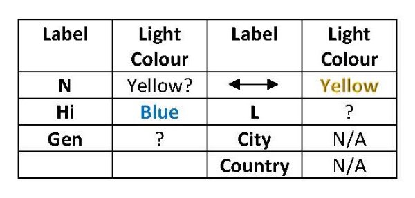

Further to the Neutral switch question, I'm now left to wonder what the warning light labelled "N" was actually connected to on the dash when there was no neutral switch? There were several dash panel types on 1974 750 GTs it would appear, one engraved, one with the 860 style decal, but both with the "N" light despite there being no neutral switch fitted....so what did the warning light indicate. In some photos it appears as if it's another yellow light (like the turn signal light indicator)......so was it a left turn signal indicator and the other marked with the arrows a right turn signal indicator?
Damien Birch's excellent Bevel Rubber site (and products by the way) has a useful list of the colours for the lights, showing early and late 750 GT warning light colour schemes - but my bike and other 1974's I've seen on the net seem to fall in between the gaps.
I can't find a wiring diagram for 750 GTs with no neutral switch but with 5 warning lights...and turn signals! Does anyone know of one existing and if so can they post it here please?
I've put a table below for people to comment on. Any help would be greatly appreciated!
