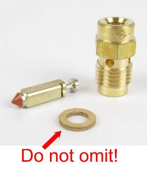

Is the seat of the needle tight and the little washerin good condition ?
When it isn't tight, fuel can dribble past it and overfill the bowl.

ducadini wrote: Wed Aug 22, 2018 11:40 pm <snip> ... and the little washer in good condition ?
And don't forget to remove the old one ... :doh:

I used the correct fiber washer between the seat and carb.

killfile wrote: Thu Aug 23, 2018 11:09 am I discovered that the banjos do not appear to be seating right into the rear carb. I did another test late last night and it appears that I can get it to seat properly with a lot of fiddling.
Stupid question ...
You do have the fuel filters in place? And the felt washers under the bolts? I know if you don't,fuel pisses everywhere ... :shock:
Banjo seals.jpg (2.58 KiB) Viewed 33022 times
