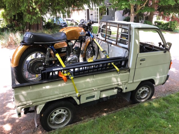

Hello,
I just acquired a partially restored 1974 750 GT. Many parts came in a box and I don’t believe it has run since 1999. 17K miles on eng.no.754314. This is a solid rotor US model built 2/74 with a black plate metal headlight mount and PHF 30 Carbs. However it has euro-style license plate mount, taillight assembly, handlebar, and indicators.
Over the next weeks I will be finishing out the restoration and I thank you all in advance for your help as/if it is needed. This is beautiful bike and my first Ducati so I am savoring every moment!

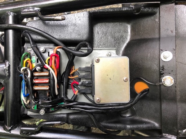

Right now I’m thinking about the wiring and whether or not a new wiring harness will affect the collectibility of this bike. Much of the bike is in original condition without having been touched by tools or bozos. It’s nice I think to keep a bike in ‘as found’ condition when possible but I want it rideable and safe too!

Hi Peter, if you plan on actually riding the thing (hopefully) then absolutely do replace the harness so you don't end up stranded somewhere.

Amen to renewing or even improving the original electrics. An ST2 Stator / rotor and MOSFET regulator / rectifier is a good thing and ditching the points for a Dyna 'S' is as well. I don't know anything about the later handlebar switches, but if they're original 40+ YO, safe to say they would certainly warrant careful examination / clean / lube. Sure is easy on one of these projects to get into the old "well, while I'm this far into it, may as well look into ________________ ".

Thanks for the advice - I was cleaning and testing connections around the fuse box this weekend and so far so good. The wiring around the battery and ignition switch are worse for age/wear. I haven’t opened up the headlamp or instrument panel yet and the handlebar switches are hanging at the moment - those are next.
I guess my biggest concern is whether theses ‘updates’ will affect the collectibility as this bike is in very nice shape. And yes, I am definitely going to ride it!
Incidentally, in the box is a Dyna coil set and an electronic points plate.
