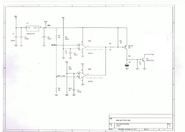

I'm pretty sure a guy called Richard Hill did one a few years back. I may have his schematic somewhere...kiwi47 wrote:Is there a fix for it? I was thinking of reverse engineering them both as I think its a dirt simple switch controlled by something that recognizes 12.8 volts or the like. Anyone been down this road?

I like the light and it won't be a problem to fix. I was just being lazy and taking the easy route.
Re: Generator light controller..VOLTIMETRO 6710603
I have the diagram and circuit board layout if you'd like to build your own. It fits in the original red plastic case.
I can't seem to upload them as they are too big (its only 400k)
