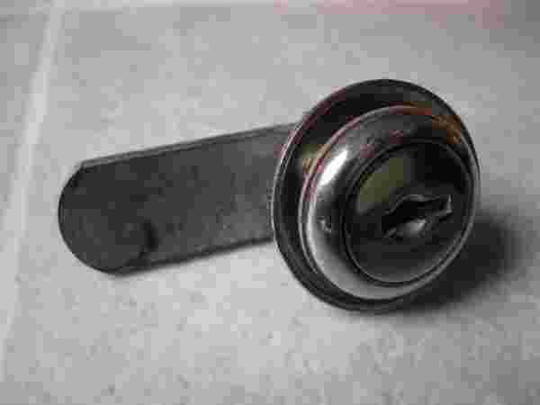

I'm working on the seat for my 74 Sport. I have the old seat frame and a new fibreglass upholstery hinged pan, but need the hinge (McMaster) and latch hardware (I'll fab this) was lost years ago. Can someone post some photos of their seat tilted up to show the latch and hinge? Also, it seems like the seat padding would hit the tank when tilting the seat pan and prevent the seat from opening very far. Is this a normally problem?

I'm in the same boat. My newly acquired 74 Sport came with a replacement seat base. The seat is not attached and the lock is missing. McMaster Carr has an impressive offering of cam locks that I think I can find one to work if we could just get someone to post a photo or two. I need to see a correct original hinge set up too.

Here are some photos of the seat latch (not mine, from a BH lister)
