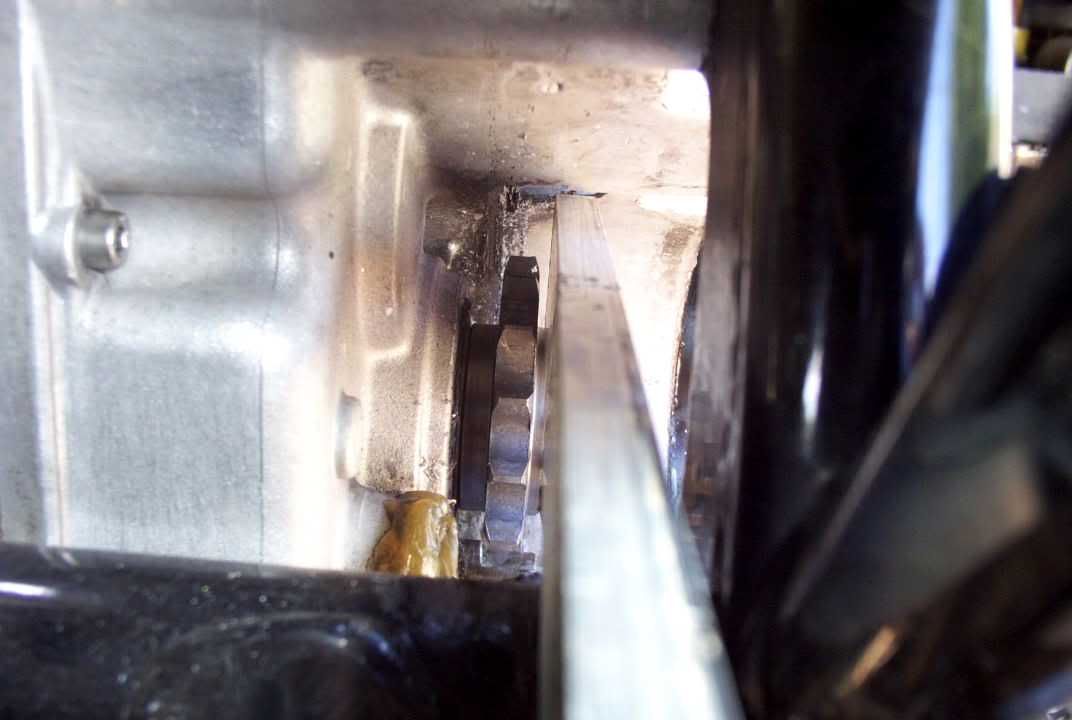

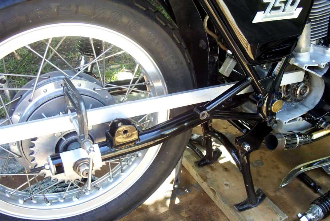

Sorry to get off the topic of how fast we all used to be, but:
You may want to use a straight edge to check your sprocket alignment
before simply turning around your countershaft sprocket.
I had a problem with my chain clearance and checked the alignment of my sprockets.
http://img.photobucket.com/albums/v85/d ... /setup.jpg
Notice that the wide boss is on the INSIDE and there is still a 5mm gap.
http://img.photobucket.com/albums/v85/d ... ap/gap.jpg
I used a 5mm thick washer behind the WIDE boss to obtain proper sprocket alignment.
http://img.photobucket.com/albums/v85/d ... p/shim.jpg
The sprockets involved are 15/34
