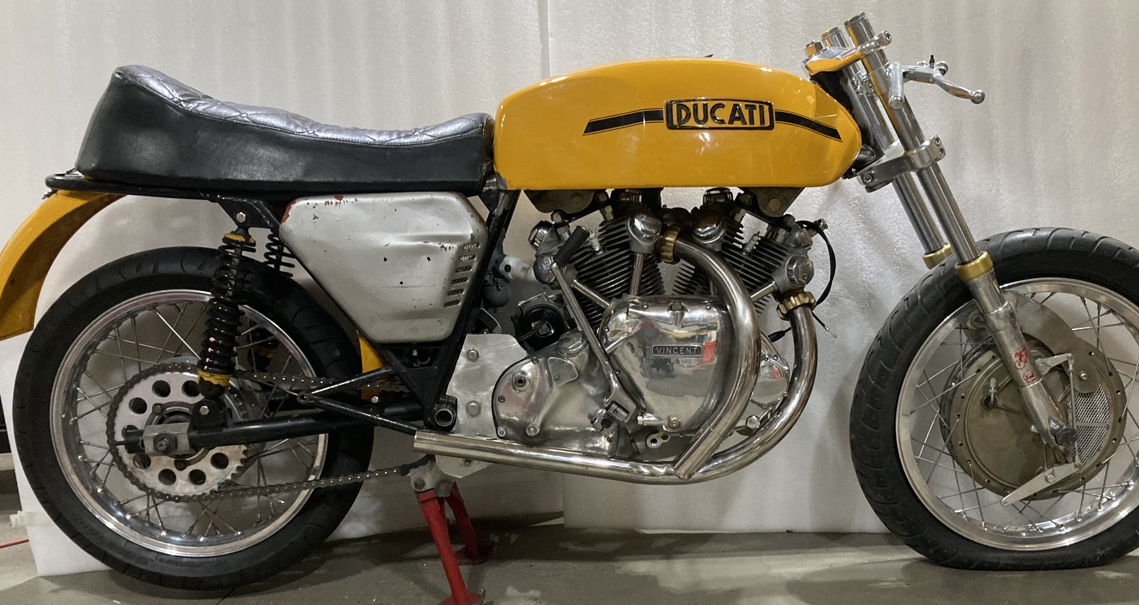

Starting from a 750 GT Frame, and a JMC Black Shadow engine.
Nuovo Forcella Italiana forks, Fontana 250 Front Brake

Very ambitious and interesting build. I love it!! What is a JMC Black shadow engine? Are these new builds of the old design?
While I do appreciate the retro styling, were it mine I would have disc’s, most certainly up front and probably at the back too.
