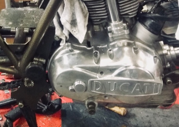

Hi Mark,
Yes I actually ordered a short shaft today from classic spares, it took some finding to make sure I got the shorter 134mm shaft.
The “round cases” came from old racing spares and are beautifully made.
I’ll try to post a couple of pics.
