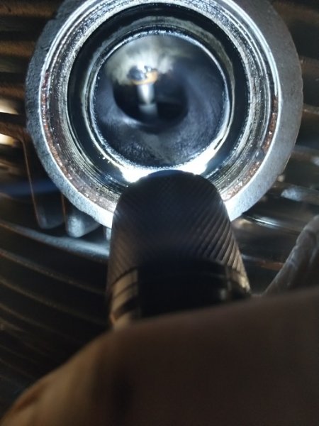

Re: desmo exhaust valve seals
Does this look like a guide leak? From either the stem or guide/head? You can just about see some oil on the end of the guide.
I am also seeing oil around the spark plug thread and when peering through I can see quite a heavy(ish) film of oil on the bore. So am I on the wrong track and it's rings?
Can oil seep into the bore via the head/barrel junction?
And here's the front exhaust - massive contrast with the camera light but it does better show the shadow in the lee side of the guide where the oil residue hasn't settled. You can also see the deposit on the guide.
