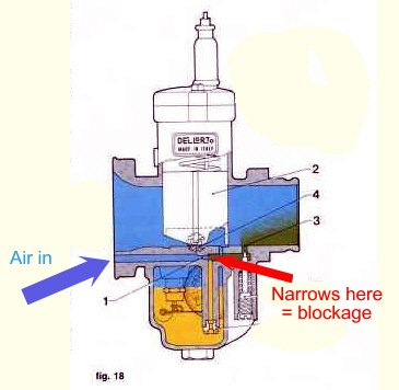

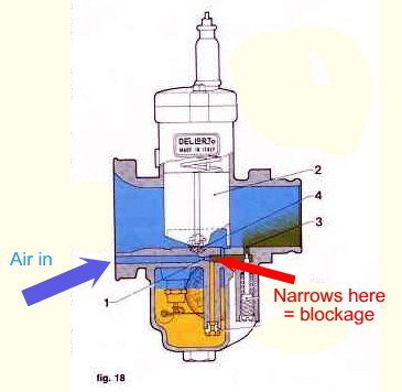

1. The idle on a PHF depends on a clean air feed as shown below.
Now, as you can see, that drilling narrows within the carb body. As you can imagine, it can easily get partially blocked at this point - and stay so, even after an ultra-sonic clean. So be very fussy.
Here's a method of checking that all the galleries are clear, given me by someone with decades of professional experience of working with these carbs. These days, I follow it every time I have a carb in my hand:
"Checking the galleries with carb cleaner.
The easy way to check the galleries with the carbs off or on the bike is:
1. Remove the pilot jet and the mixture screw.
2. If the carb is still on the bike, open the throttle. Using a can of carb cleaner with an extension tube fitted, put the tube up the hole where the pilot jet goes. Cover the mixture screw hole with finger and squirt cleaner while looking for a stream coming up into the venturi, just in front of the back edge of the slide.
3. Then put the tube in the mixture screw hole. This time, cover the pilot jet hole with your finger and squirt cleaner whilst looking for a stream coming out between the slide and the engine.
4. Then put the tube into the little air hole under the main air intake (not the "middle" one: the one on the side). Squirt, and look for cleaner in venturi."

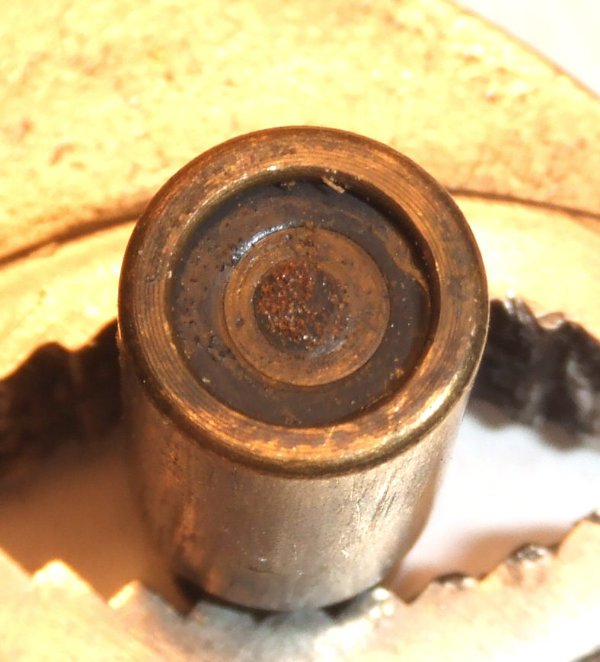

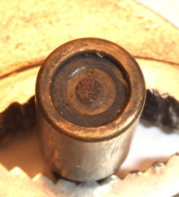

Oh, and maybe this will help.
If your choke piston looks like this, change it.

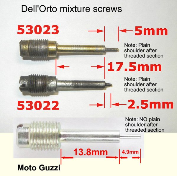

When you say the mixture screw is longer.you mean physically.If that is the case you have the wrong mixture screw.I would say the shorter one is correct.I raised this on the forum before.

Yes, the taper section is visibly longer. (Estimate 0.5mm.) Inspected both under magnifying light thinking that shorter one may have tampered with but appears to be original.
Correct me if i am wrong but the mixture screw on these carbs adjusts fuel flow.
Searching forum suggests that screws should be wound out between 1.5 & 2 turns as a starting point. The original rear carb is happy within this range, the front carb with shorter screw (which appears to be running rich) will presumably require less turns out.

mdal8798 wrote: Mon Jul 20, 2020 12:53 am Yes, the taper section is visibly longer. (Estimate 0.5mm.) Inspected both under magnifying light thinking that shorter one may have tampered with but appears to be original.
There are at least 3 versions of the PHF/PHM mixture screw, 2 of which you can find on Bevels - see the picture below, with thanks to Steve A for the info on the top two.
I'm reasonably confident in saying that if you have AD/AS carbs, you should have the shorter ones. If you have CD/CS carbs, it should be the longer ones.
Me, I'd want to have a pair of the correct ones. For you in Oz, Mark, Phil Hitchcock at Road and Race in Sydney (amongst others) should be able to supply.
mdal8798 wrote: Mon Jul 20, 2020 12:53 amCorrect me if i am wrong, but the mixture screw on these carbs adjusts fuel flow.
Correct. The strength/weakness of the air-fuel mixture is determined by the air drilling at the front of the carb and the size of the idle jet. The screw regulates the amount of this mixture.
mdal8798 wrote: Mon Jul 20, 2020 12:53 am Searching forum suggests that screws should be wound out between 1.5 & 2 turns as a starting point.
Correct. That should get the motor running. After that, a bit of carb balancing/tuning may - or may not - alter it slightly.

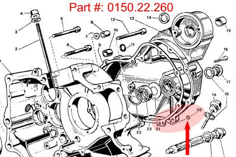

I am just waiting on getting a 22mm bolt turned down so i can remove engine side cover to inspect pickups.
Re: Darmah Front cylinder running rich
mdal8798 wrote: Mon Jul 20, 2020 4:40 pm I am just waiting on getting a 22mm bolt turned down so i can remove engine side cover to inspect pickups.
In practice, you don't need to fab up a puller, Mark. Once all the screws around the cover are out, some gentle taps with a rubber mallet all around the casing will release it. (I guess you know to first release the starter chain - it's all in the w/shop manual. Watch for the shims).
Don't forget to order up a new gasket* - again, ask Phil. And also:
There is a poxy little O-ring at the bottom of the cover which me, I almost always forget to order at the same time :doh: . 'Push comes to shove', you can re-use it. But for the few extra cents, it ain't worth it. Part number 0150.22.260.
* Fit the new gasket using just a thin layer of regular grease on each side. No gasket glue. And apologies if I'm telling my grandmother how to suck eggs :shock:
