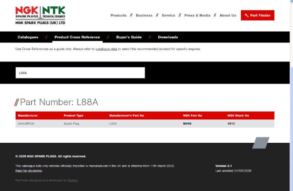

Re: Bosch WR 8 AP spark plug issue
rjk40 wrote: Thu Sep 10, 2020 11:00 am <snip> The original Champion L88As are no longer made, so I am at a loss on what to do.
Hi Richard,
Personally ... :)
Just fit NGKs - B6HS, to be precise. It's the equivalent of the old Champion L88A and I've been doing it for the last 40-odd years ... :-D

rjk40
Posts: 194
Joined: Thu Dec 05, 2013 10:54 am
Location: Malabar, Florida
Post by rjk40 »
Thanks Craig,
I shall do that.
Richard
