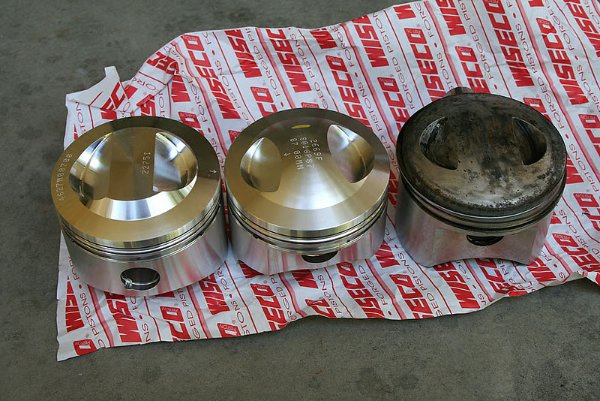

I love your work, does not look like a Wiseco anymore, attached a photo showing the latest Wiseco on the left with the old style Wiseco (1990s) and an original fitment AE. I found the middle one too high a C.R. for road work so I "de-crowned" it in the lathe basically took the bump (5 mm) off the top and its now like the stock SS piston, C.R. is now around 9.6.
Did you use a stock Ducati gudgeon/wrist pin?
Jock

Thank you Jock, I used the Wiseco pins but faced them off to stock length using black ceramic inserts.
That center Wiseco piston from the 90's looks a lot closer to stock with the skirts machined off and a shorter pin.
So now it looks like they had it right at one time but radically changed the design.

Yes, the earlier type were also available in other sizes too, I have a set of 88 mm Wiseco pistons in my Darmah, which I also "de-crowned" The pistons lost 20 gm in machining from 378 gm to 358 gm, the stock AE weigh 364. I think the modern Wisecos are a bit strange, I suspect they are designed for another engine but they are cheap ! but too heavy.
