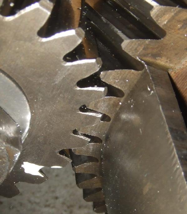

As per the title is there a recommended alignment of the primary gears?
By alignment I mean should the primary gear be sitting bang in the middle of the clutch basket gear, or is it allowed to be a little further back as it presently is on mine? i.e
Oh r's I can't even draw a basic diagram in a post, ahem, so give me a moment or two....

The gears should be pretty well lined up, the engine gear is fixed due to being mounted on a taper. There should be a thickish washer behind the clutch basket, between the case bearing and the bearings in the basket. You might have an issue with the bearings in the basket. There should be a spacer between them and I think there is a circlip retaining them. If I remember correctly there was a production change in the bearings noted in the parts book. It has been a very long time since I looked at my bike but I think mine were mis aligned by a few mm's but there was no unusual noise or wear evident.
Just popped out and measured and the clutch gear is ~1.5mm proud of the primary gear. And from what I can remember there was no unusual noises when it was last running.
I'm putting in a sachse ignition system & as I'm in there I might as well whip the basket out just to check nothing is awry. A quick check of the gear selector spring thingumybob wouldn't be out of order either.

I just looked at mine, and estimate the clutch gear to be the same as andybaggies' about 1.5mm proud of the primary gear.
Thanks for the confirmation. Taking the clutch drum off at the weekend showed the 4.8mm spacer was fitted but no extra shims. All looks clean so I'm happy with that :)
