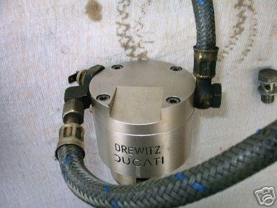

I have an MHR which was imported to the UK from Germany. It's fitted with a full-flow oil filter system by a company called Drewitz which no longer exist.My problem is that the filter used is not the standard one used by Ducati. It has the same dimensions but has a one-way valve at the bottom and a raised spigot at the top. I'm hoping someone might know what the part number is or can suggest how I might ID the filter.

Interesting set-up; mine's only half way. I found this on the Internet, same as yours: http://anthonygodin.co.uk/car/ducati-mhr/ It looks like a really clean system. Is there a cooler somewhere?
What does the filter look like inside the Drewitz casing? I'm trying to work out how it works from pictures. Does the whole thing have to be removed to access a filter underneath? Please tell more about the filter already in the Drewitz system.
Here's mine for reference. I'm only half-flow with a radiator from a Kwacker 650. Mine also has a real, magnetic sump plug on the bottom, an oil level window and an easier access filler on the clutch casing; my bike was made for me, not anyone else so I don't care what the purists say about this "butchering". A few shiny ally bits too. Note my system has a little FRAM screw on filter; still have to shift the front carb to get it on and off.

Ducatiwerkstatt Drewitz, highly likely Georg Drewitz who I think is the guy who did the work on your bike. Worth a try calling the phone number in the link.

I have managed to ID the filter, it's from the old Yamaha XT500.

81mhr900ss wrote: Wed Jul 11, 2018 10:12 pm Interesting set-up; mine's only half way. I found this on the Internet, same as yours: http://anthonygodin.co.uk/car/ducati-mhr/ It looks like a really clean system. Is there a cooler somewhere?
Hi,yes the top has to be removed to access the filter.. The lower part with Drewitz stamped on it is fixed but I can't see how. My SS has a similar system to the one you are running. I did have feeds to the heads but got rid of them. I also run an oil cooler on that bike.Like yours it is not full flow. The SS needs restoration and will probably be returned to standard, The MHR will run as-is for the forseeable future. MHR is down for a bottom end rebuild...
