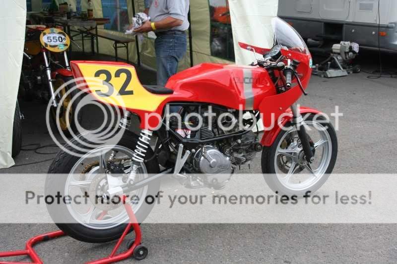

Alazzurra: The best solution by far. Not too expensive, and underneath that ugly clothing is a half decent motorcycle. Make your own racer ...
Or go the Whole Hog in the form of a TT2 Replica (altho' this is a real one):
Have fun!
P.s If you really want to get into TT2 Replica building, have a look here. All you need, including a proper Verlicchi frame :Uwin: :
