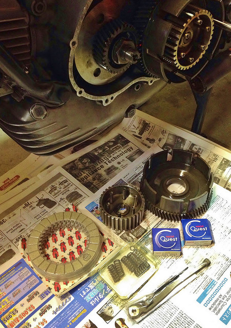

Hello All,
Just an update with respect to my original question on clutch basket bearings......
I have decided to go with sealed bearings with C3 clearances ....... C3 to accomodate the press fit, and sealed because my original bearings were sealed and they seem just fine after 50K miles. My original intent was to use SKF bearings, but I could not find an online source for SKF with the sealed/C3/Snap Ring configuration. So, instead I went with Nachi; a good quality Japanese manufacturer I understand. The Nachi part numbers are:
6005-2NSENR - 25x47x12 Deep Groove Ball Bearing, C3 clearance, Sealed, with Snap Ring.
6205-2NSE - 25x52x15 Deep Groove Ball Bearing, C3 clearance, Sealed.
I was able to order these online at VXB Online Bearings for a pretty reasonable price.
The remainder of my clutch upgrade includes:
1) Later model clutch basket and hub
2) New friction plates
3) Heavy clutch springs
4) Longer "light pull" clutch lever kit
The last detail to work through (I think) is the clutch push rod / ball / spacer length. With the new deeper clutch basket I think some adjustment will be needed here. I'll figure that out when the other parts are installed.
Old905Duc

A few thoughts on clutch basket bearing installation .........
None of my manuals gave any information on bearing installation for the clutch basket .... its all intuative, no?. Anyway, I learned a few things in my first trial:
1) Heating the basket makes the installation quite easy. I used my wifes hair drier to get the basket as warm as possible.
2) Cooling the bearings also helps. I put the bearings in the refrigerator over night. I decided not to put them in the freezer just because I did not like the idea of freezing the grease, but this may not be a problem.
3) The larger 52mm OD bearing just needs to be driven to the shoulder in the basket bore. I used a big socket that matched the bearing outer race size. This way I was not tapping directly on the bearing race. The socket is held against the bearing and I tap on the socket with a hammer.
4) The smaller 47mm OD bearing takes a little more attention. Again I used a large socket matching the bearing outer race to drive it into position. In this case there is no shoulder to set the position. The bearing has a snap ring in the outer race, but this cannot be used to set the seated position. I mistakenly used the snap ring as a guide and this resulted in too much prelaod on the bearings (too tight). I ended up driving them back out and then ordered new bearings. Instead you need to drive them until the inner races just touch. As you get close you need to keep checking so that you do not drive too far and induce too much preload in the bearings.
Other than these points I cleaned the basket bearing bores well and lightly dressed them with motor oil. I then wiped off the oil with paper towels which left just an extremely slight residue. My thinking is that this is better than a totally dry interface when pressing the bearings in place.
At this point I am waiting for my new set of bearings because I do not want to re-use the set that I pushed out (due to high preload) since I likely damaged the bearings when I removed them ...... although they did not seem to be indented(?).
Old905Duc

Progress Update.........
I have received my second set of bearings and successfully installed them into the clutch basket with no issues. This time I was very careful to SLOWLY tap and check the position of the smaller snap ring bearing until it just touched the matching inner race of the larger opposed bearing. No binding this time and the bearings turn freely. As before I heated the basket with a hair drier and cooled the bearings in the refrigerator over night. I also used sockets that matched the OD of the bearings placed against the bearing OD races and tapped on the socket rather than directly on the bearing. They went in easily.
Installation of the basket and hub onto the transmission shaft was straight forward. Since the engine was still in the frame I did not use the clutch tool (I don't have one) while tightening the hub nut. Instead I put the tramsmission in high gear, locked the rear brake, and placed a study bar between the rear wheel spokes and the swing arm. This stopped all rotation and allowed me to easily apply the full tightening torque to the hub nut.
I soaked the new friction disks in engine oil for a few days (not sure if this is really necessary) and installed the new friction plates and cleaned up the old steel plates. At this point I now have the later version clutch basket/hub/clutch plates installed on my early 860 , but we are not quite done yet.
I had decided to also install new HEAVY clutch springs for a good grip. Since the clutch pull was already "manly" with the original springs I decided to also install the easy pull longer clutch lever that Steve sells. Installation of the longer lever was easy ..... but you will need a snap ring pliers of the correct size. Installation of the heavier springs caused me some problems. It seems that the heavy springs are also longer than the originals. I found it quite hard to compress the springs to the point of engaging the screw threads. At this point I referred to the parts manuals and determined that the shims used in the screw cups (for early 860's) were not used on the later clutch design. Removing the shims helped but I was still afraid of stripping the initial threads. So, after checking the thread depth I decided to buy new (slightly) longer screws. The original screws are M5x12. The perfect size (I think) would be M5x14. I could not find that size but I ordered M5x16 which I will either cut down or use washers to reduce the effective length. The screws are now on order. Since I was buying new screws I also decided to change the head type to a flanged hex bolt head from the original slotted head. This will make it easier to compress the spring and eliminate the fragile screw driver slot. At this point I am waiting for the clutch screws to be delivered.......... could not find them locally.
Old905Duc
