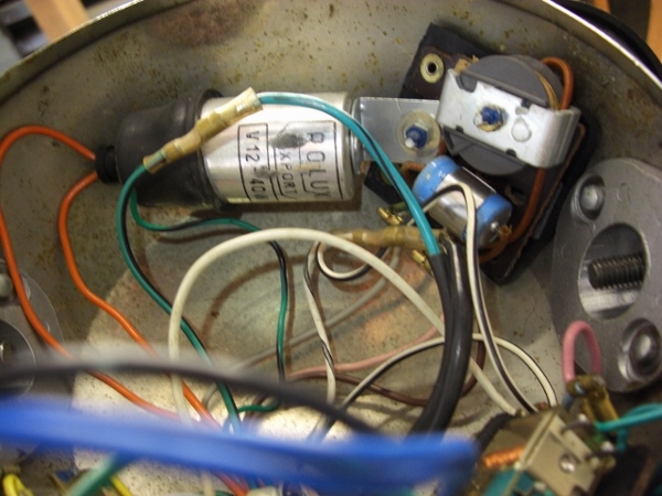

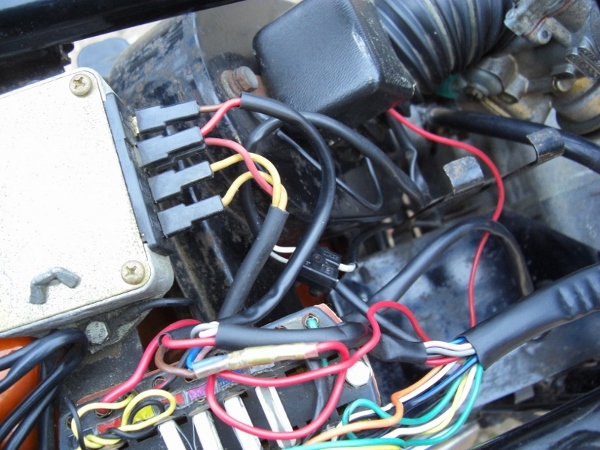

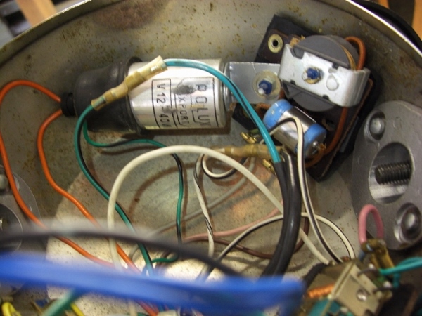

Hi Craig.....thank you for that; I followed your advice and checked all the connections to the Reg/Rectifier, and they all seemed fine; nonetheless I crimped each one very slightly to ensure a proper interference fit.
I then took a look at the fuses and cleaned the pointy ends of each one back to bright metal and the retainer posts with a fibreglass pencil until they were also free of any dirt or corrosion.
The battery showed 12.65V on the meter. I started it and if I'm honest I expected no improvement as I hadn't found an obvious fault......but to my great surprise and delight I got sensible and normal charge readings up to 14.2V from memory......superb and thank you. -?-
The indicators still flashed too fast when the engine was revved :doh: but given the apparent mis match between the relay and the bulbs perhaps that is to be expected....I've ordered a set of 21W Festoons and we'll see what that does.

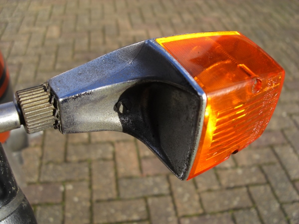

The turn signals themselves are these little square chrome jobs......I really like them, but I have noticed they seem to be thin on the ground, not a single one on ebay in the three months I've been looking so I guess I'd better look after them and not over tighten the screws etc.
Thank you for the help, much appreciated............Mick.

I think that style indicator is almost impossible to find these days although I do have a set from an 860GT I owned years ago.

As Bruce has said, those indicators are indeed rare. I don't remember ever seeing any on eBay (altho', fair to say, I haven't been looking particularly). Look after them well ...

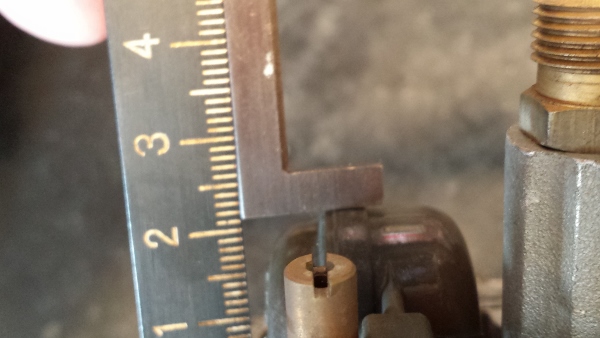

Hi Craig.......I took the carbs out today, everything is stock, jets, throttle slide etc and quite nice and clean inside.

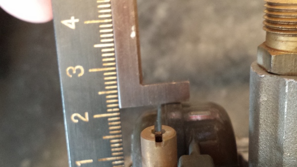

The only thing I noticed that needs attention beyond cleaning is the float height.......21mm both sides, where as I understand it, it should be between 17.5 and 18.5mm.
I have done one.......bending the arms of the floats to achieve the desired adjustment, having read another post on the subject.......I admit to being sceptical on that point, I thought it would almost certainly be easier to bend the valve tang....but on close inspection it's definitely sensible to bend the arms.
One thing though......I have noticed on other threads that 21 or 22mm seems to be the height set at the factory.....I'm certain mine have never been altered...why would that be if it should be 18mm? that's quite a difference.
Sorry for the unclear photo......but it the float height gauge at 21mm as found.
Best...........Mick........kettle738

kettle738 wrote: I have noticed on other threads that 21 or 22mm seems to be the height set at the factory.....I'm certain mine have never been altered...why would that be if it should be 18mm? that's quite a difference.
Hmm - that had me scurrying to the books!
Typically, both the 860 workshop manual and owner's manual are silent on the subject :evil: . However, as well as the Dell'Orto Guide:
1. Both the 1975-1977 750/900SS manual and first edition Darmah manual, each being subtitled "Supplement to 860 GT/GTS Workshop Manual", say 17.5 -18.5mm.
2. Ditto the Pantah manual and the Laverda RGS manual, both bikes also being users of PHF carbs.
So that makes 5 sources each claiming 17.5-18.5 :) . Do you know the origin of the 21mm?
