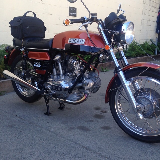

Re: 750GT Rolling Basket Challange
Just back from a 2 day, 800 km. / 500 mile trip from Vancouver.
Went with friend Ian Watson with him riding his '72 BSA Rocket Three. Ran like a freight train - no break-downs, no crashes, no roadside conversations with constable Bob and no near misses with Bambi.
Interestingly, Ian's BSA & the 750 GT were both getting almost exactly the same fuel consumption - 38 - 40 MPG (US) (6.2 - 5.9 liters / 100 km.). The GT, even after showing about the right F/A ratio on the dyno at cruise RPM in 5th, still shows a soot accumulation at the ends of the mufflers like it's running a bit rich. I dropped the needles and changed the pilot jets from 62's to 60's (slight blubber off idle that I'm still fussing around with).
Used about .3 liter of Lucas SAE 50 Motorcycle oil. BR6HS plugs looked on the rich side of in the right color range.
A bit of oil leakage out of the early style tach drive which may be just the way they are since I see no o-ring or seal in there, only a little oil slinger on the input shaft inside the gear cover. Also found oil leaking out the back from the chain / sprocket area. Shift selector shaft seal is definitely leaking, but the oil is traveling to the case/ shift selector housing joint, which does not seem possible from the shift shaft leak. May have output shaft seals leaking too. Will be replacing all three.
Felt a bit of pulse through the front brake lever again. Measured and DAMN! After I cut it to perfectly straight 2500 km ago, it's got .020" run-out. Not surprised since this happened to a Guzzi fixed iron brake of mine a few years ago. I now know that truing a warped fixed iron disc is a waste of time. Have a new disc on the way from Ian Gowanloch.
Bridgestone Spitfires are the hot set-up (32 / 34 PSI).
BTW - if you're in Victoria BC, make sure to stop by Wheelies Coffee, Bar & Motorcycle Shop. Great folks that gave us some local fabulous road tips and served up fantastic sandwiches:
http://www.wheeliesmotorcycles.ca/
http://instagram.com/wheeliesmotorcycles
