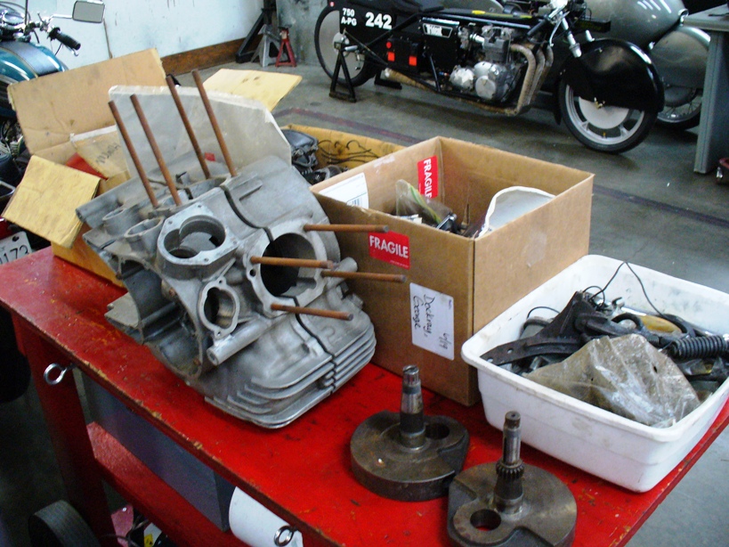

Was able to seal the deal and get the ownership paperwork. Picked up the boxes containing the engine parts and a few misc. bits like side covers, kick starter lever, side stand, etc. Tomorrow I'll pick up the rolling chassis then clean, sort, inventory.

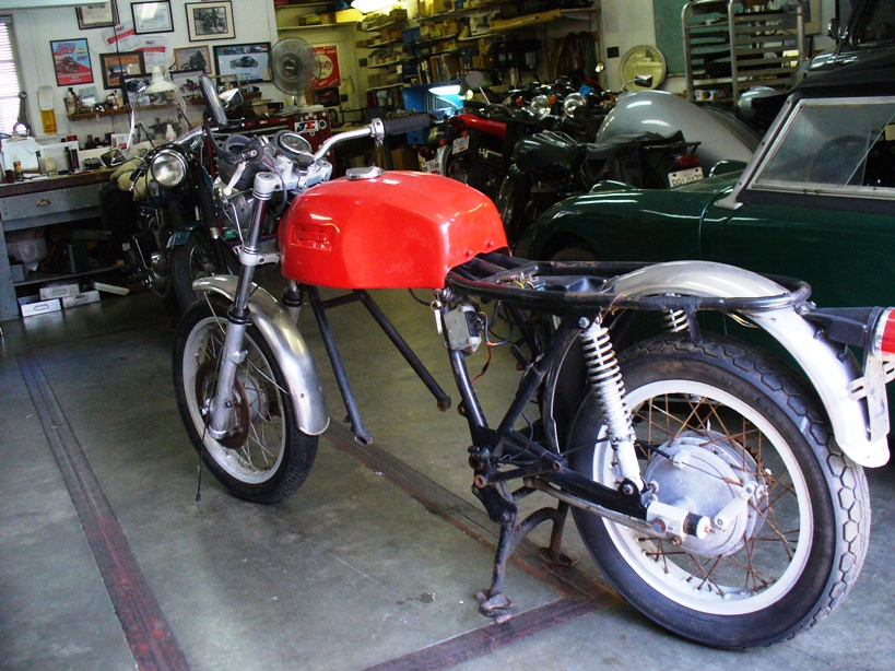

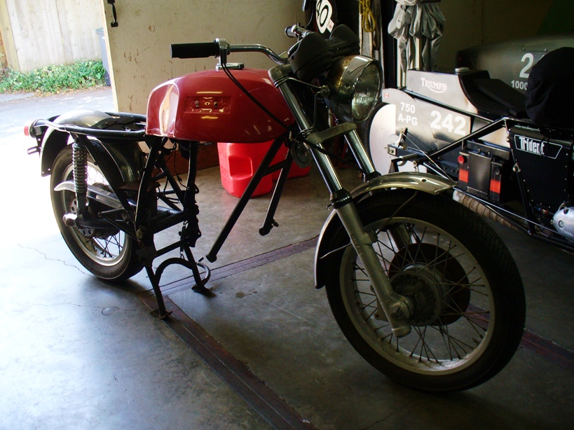

Got the rolling chassis today ...................... well, rolling after I removed the seized front (Lockheed) caliper.

You have an unusual machine there. Most 73's had a fiberglass tank in the US. Your rear shocks do not look like stock either. It has the stainless fenders which are nice. Have fun finding those cylinders. I seem to recall a site in the UK which might have them.
Re: 750GT Rolling Basket Challange
If you remember the place in the UK that might have them, please post.thessler3 wrote:You have an unusual machine there. Most 73's had a fiberglass tank in the US. Your rear shocks do not look like stock either. It has the stainless fenders which are nice. Have fun finding those cylinders. I seem to recall a site in the UK which might have them.

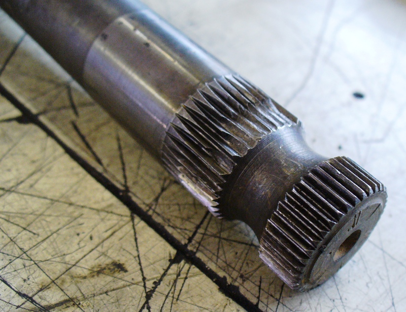

Started cleaning, inventorying and inspecting the engine parts today. Nothing obvious for trouble (the crank pin / big-ends which I knew already) except a ruined kick starter shaft spline. Seems that I read somewhere that an 860 / 900 shaft assembly would work as a replacement.
A number of 'mystery shims" that were in the bottom of one of the boxes with (among other things) gearbox parts.
Layshaft 5th gear is stuck on the shaft. Not seized, just stuck to where I'll need a puller to get it off. Odd .................... I've also heard that there are some lubrication mods that can be incorporated into the gearbox, though nothing specific as to what those mods might be.
Clutch hub has considerable notching from friction plate splines. Very little on the basket segments from metal plates. Heard of a (surflex?) replacement that provides adequate grab, but requires less clutch lever effort (lighter springs?). Longer clutch actuator arm is available (recommended?)
How the &$)@*@ do you get the snap ring out of the breather housing w/o stabbing yourself in the hand w/ the awl I'm trying to get under the end with?

One problem with kick starter shaft (315mm type). It looks like the kick starter was loose at some point and the through bolt wore into the splines. I've had no good suggestions for ways to make a permanent repair. This shaft is apparently available reproduced for about $400 CDN. Not wanting to assemble and just hope that with the kick starter lever well cinched down, it won't end up with further stripped splines and then having to re-split the cases to deal with it, I'll probably spring for the new shaft.

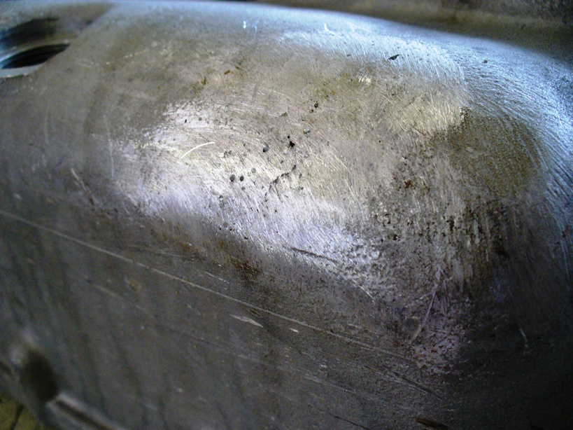

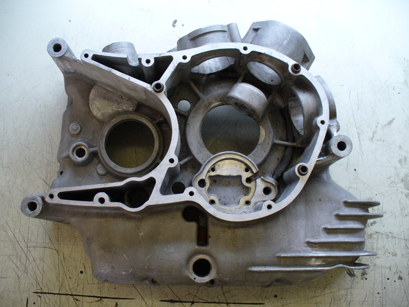

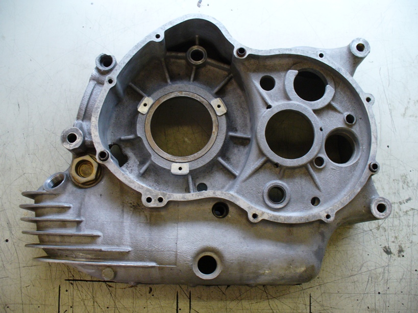

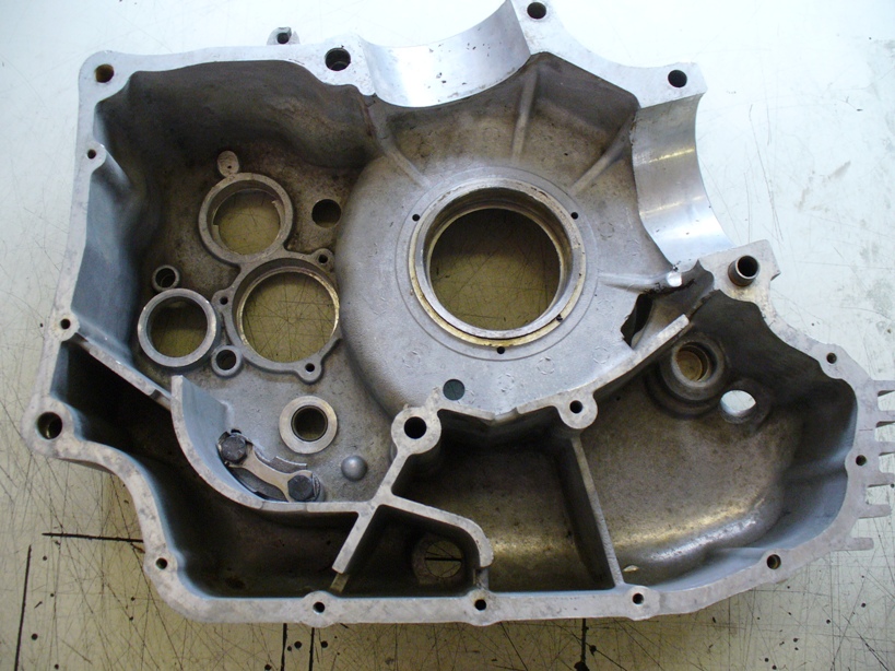

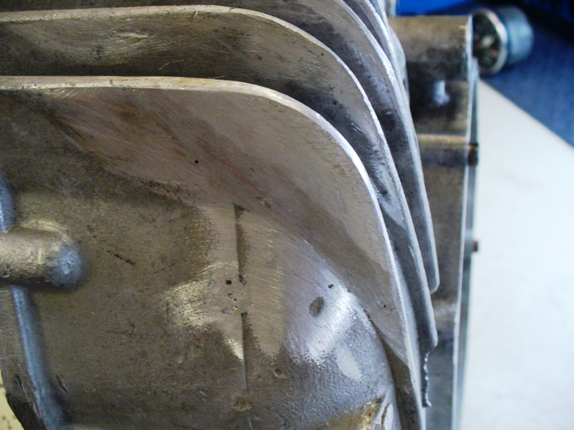

Cases are all cleaned and inspected. The reason for the disassembly may have revealed itself. I see that in the RH case, above the drive sprocket that there has been a weld repair done. Looks like the chain let go and knocked out a chunk. The repair looks very well done (my machinist / welder friend had a look and pronounced himself impressed).

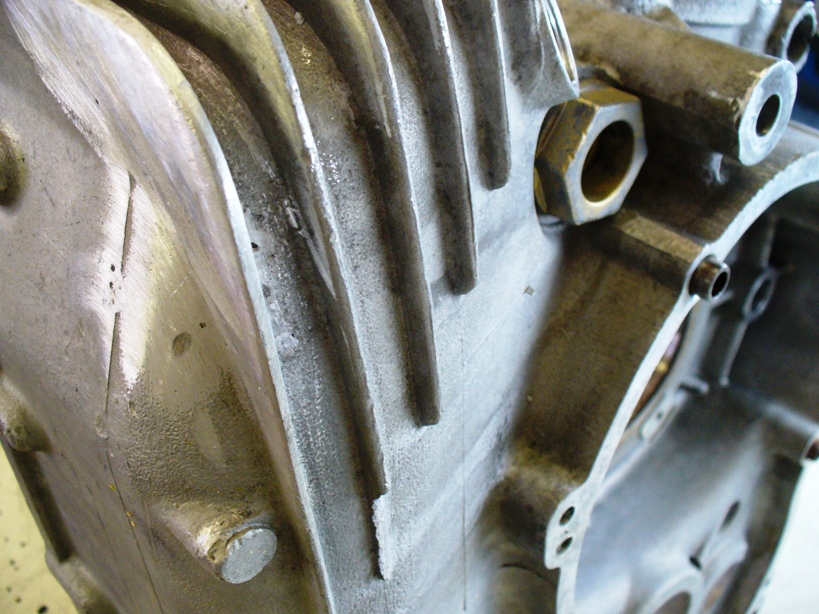

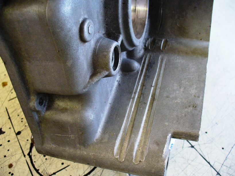

Interesting too is evidence of other welding - the lower fin on the RH sump case half has been repaired by the build-up and grind down method as you can see in the picture below. Again, very nicely done. There other evidence of grinding, though no internal evidence of welding on the RH sump. Trying to fix a porosity leak?

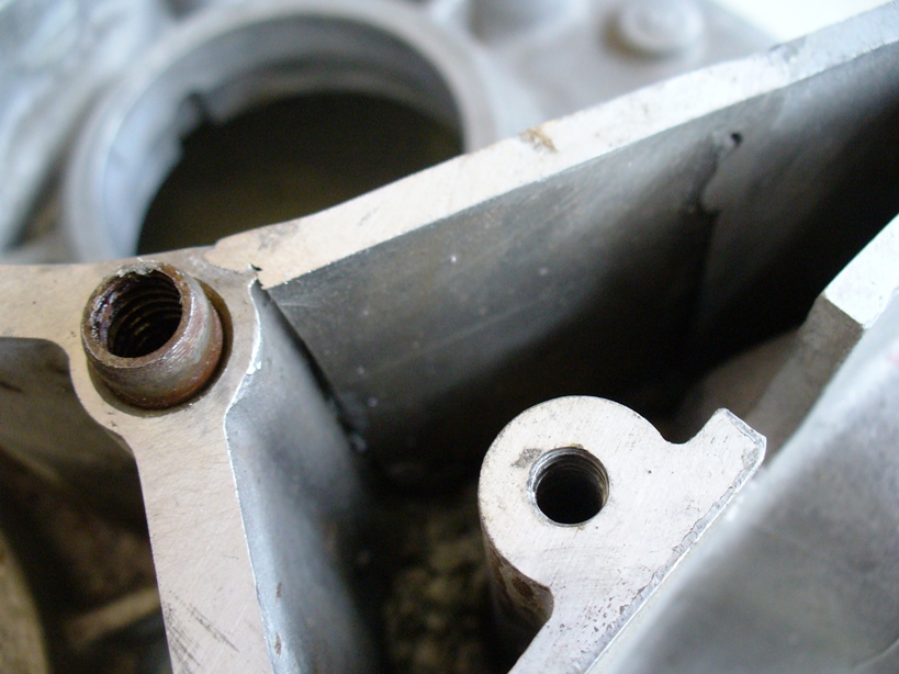

There was also some grinding evidence on the RH case, forward engine mount boss. Very hard to tell whether it was welded or just just ground for a bit of aesthetic smoothing.
Previous owner looks to have been less than diligent on keeping his chain adjusted too.

Thanks for posting all the pix - keep it up!
one of my case saver kits will help keep the chain from grinding into your case (typical things for all bevel twins actually)
A tip for making the cases look less like there has been grinding etc is to use a very course sand and sand plast the aluminum where it was ground or wire wheeled. With patience you can hid that pretty well from glances... You will always see it of course, but the casual observer may not notice.
